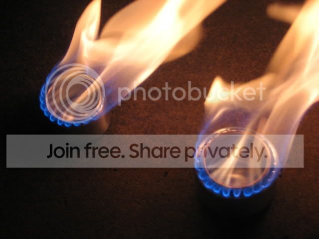

I didnt make the penny stove because it requires priming and sealing and the fueling seemed complicated to me. So i sacrificed the faster boiling times for ease of use and construction for this kind -
These were heaps fun to make and the instructions from zen stoves were great - they even had templates for evenly punching the holes and for the inner wall. I removed all the paint because it looks cooler.
THe little one in the picture is made from the small V cans which are narrower, it holds significantly less fuel so is better suited for warming a meal or just playing and showing off.
These work great because the priming is done all by itself without the need for a dish, but the bigger ones needs to be quite full for it to be able to boil 500ml of water for Ramen in one go. The most annoying thing is punching the 24 holes with a thumb tack. I even made a pot stand out of a tin can.

Oh... mine has the yellow flame because it was VERY windy that night, and I was taking those pics to show a friend that a pot stand/ windscreen is quite the necessity in windy weather. I boiled 500ml with that one on the same night and it took 20mins. But in normal conditions it took 10 mins.
