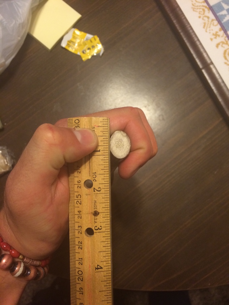

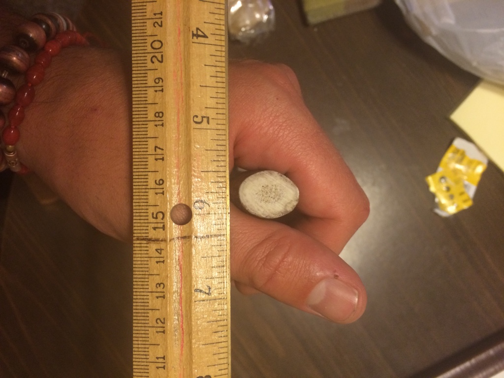

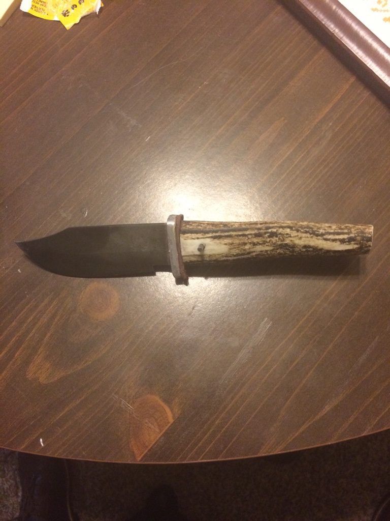

Finishing the hidden tang project I was working on.
Now my question is, what is the best way to attach a pommel to the handle and what should use. I searched the forum and couldn't come up with any thing.
Is there a better way to attach besides epoxy? I am only working with hand tools as well.
Thanks guys!

Thanks guys. I ended up doing a blind hole then epoxied a treated rod in and put a small ss cap on it. Now it's just finish sanding and going over all the rough areas and making a sheath.
Thanks for all the advice

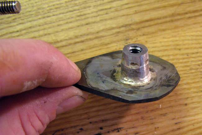

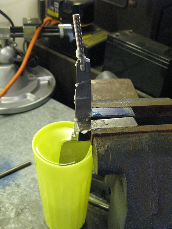

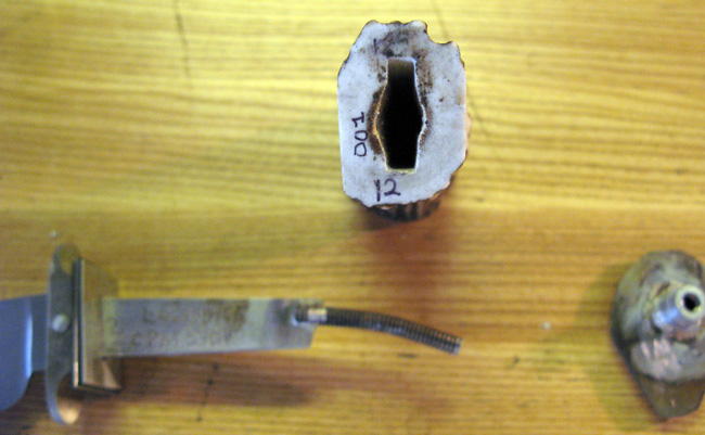

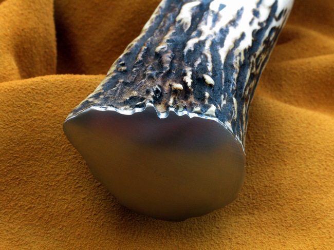

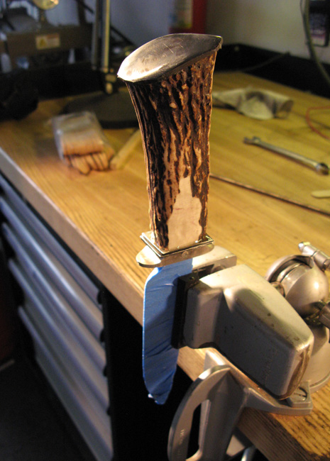

It seems as if you have solved your problem thanks to the input from others, but if I know I am going to need a pommel I'd rather do it another way and fasten the pommel to the end of the hidden tang.
It may be a more difficult and extreme, but it eliminates the need for a pin and allows the handle, spacers, and pommel to tighten very securely. The whole assembly is "screwed and glued" together.
I did a tutorial years ago which is located at HERE but here are a few photos to get the idea across.
Mike , I have seen these photos before and I love the way you attached the cap to the antler. First class!! Thanks for the info. Larry Lehman
