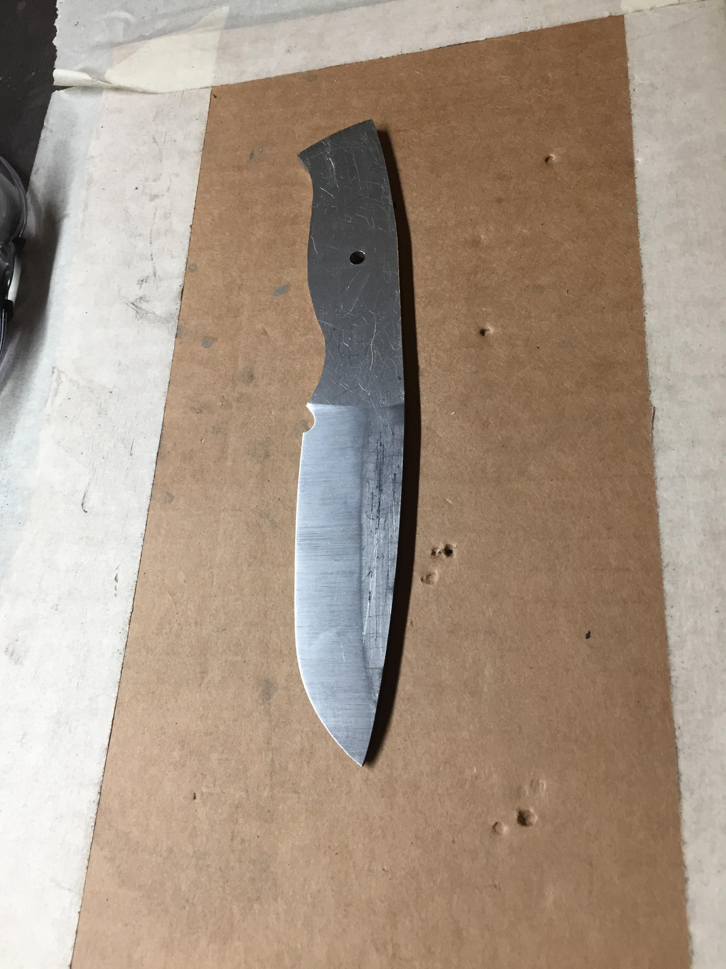

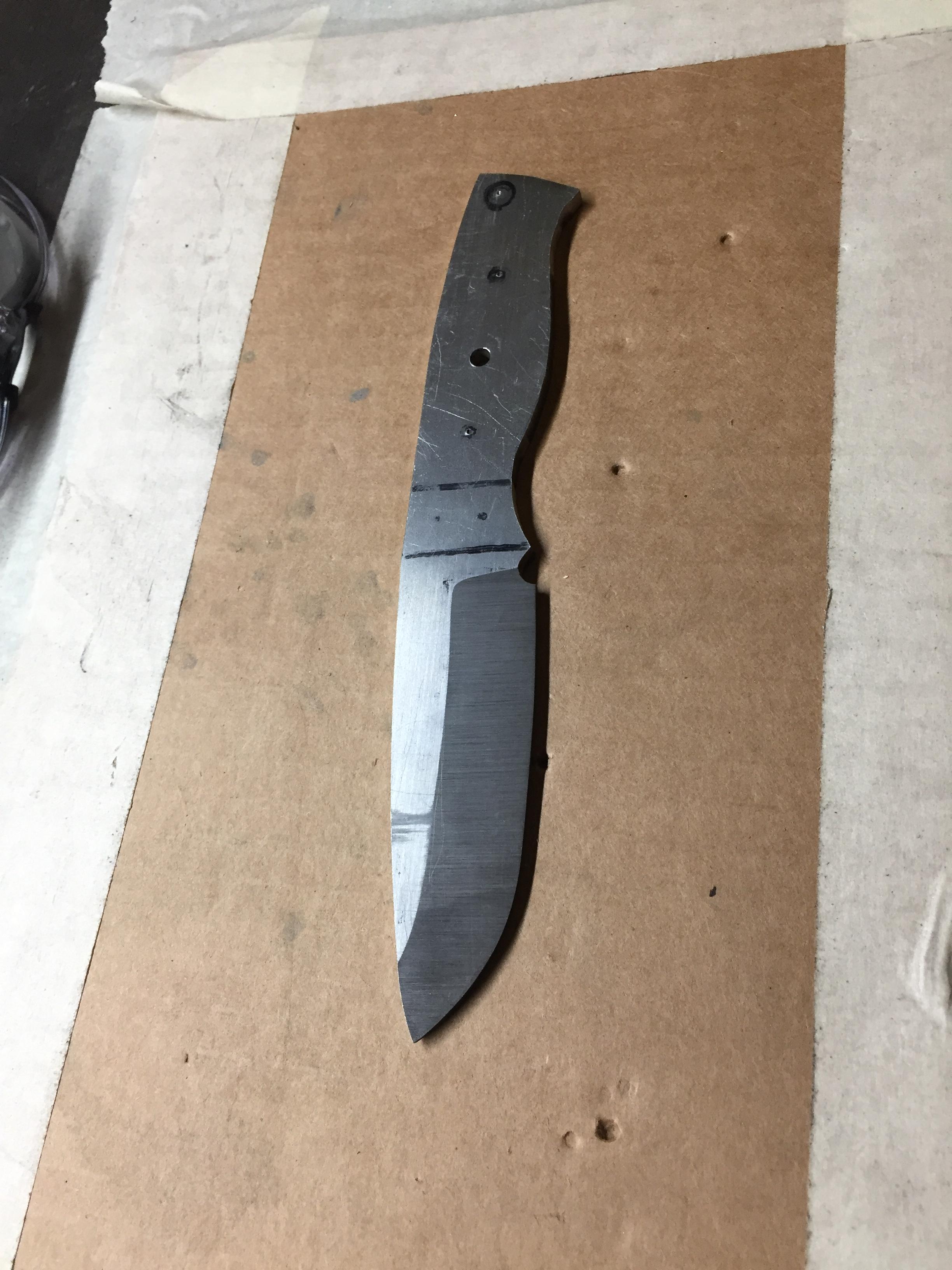

Im trying to practice freehand putting a primary bevel onto my stock removal knife. Since i dont want to overheat it i have to take it away from the belt sander frequently. I want a crisp plunge line but i dont see it happening with how im going after it. Any advice? When i move onto 1084 will i have more luck just keeping it steady and only rotating to get the right bevel per side?

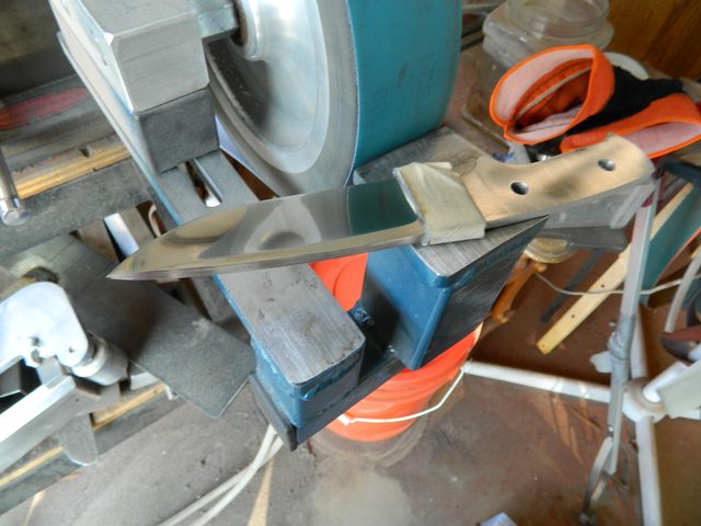

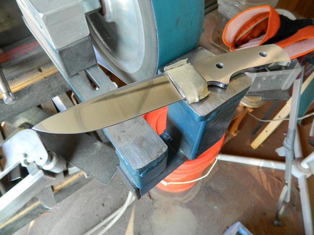

When I started to hollow grind blades I watched the video by Johnny Stout called the "Art of Hollow Grinding" and he used masking tape wrapped several times around blade blank at the plunge line. He used the tape as a guide and sort of a stop to keep from grinding too far back into the plunge and keep both sides the same. I think he meant to do this this until you are experienced at hollow grinding but I still do this on almost every blade even though I probably don't need to. This might help with your plunge lines. Larry

also I recommend starting about 1/4" ahead of where you want the plunge. When you have the primary set, the start at the real plunge line and gently sculpt it until it meets the top of the bevel.

I simply scribe a line along the edge where the plunge should be.
Start grinding well ahead of where your plunge should be, and work your way back.
Im going for more of a hollow grind. Like i said the really difficult part is this knife is my 1st and its a stock removal so i have to constantly let it cool off some before i go back to the belt. My next knife wont be stock removal so i think it will go better. Ill look into the file guides.
