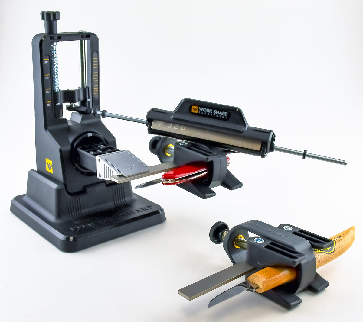

Help with really Small blades Worksharp precision Adjust Knife Sharpener
Have a look at some more pics-
Small blades can be challenging, on my clamp system I made a 'shelf' that is clamped and extends out to a small shelf that I lay the blade on, so the knife isn't clamped but held by hand, similar to the Edgepro style and that does a pretty good job.
But on teeny tiny blades like this one, I used my guided worksharp and that did pretty good, basically freehanding it but using the grits on the tool, key is the blade needs to have a good grind down to the edge, otherwise you have a chisel and that sometimes is hard to get to cut well.

Unless the OP has a mentor to show him what to look for and how it feels to correctly find the bevel, learning freehand sharpening is not that simple. I never got the hang of it until I bought an Edgepro (EP) 20+ years ago. Once I used that, and started getting some truly sharp edges, it absolutely showed me what to look for and how grit progression should feel. And the first knife I sharpened on the EP was razor sharp on my very first try. Plus, when I want to thin the edge bevel, the EP allows me to do that with enough precision, it looks like it came from the factory or knife maker.
While I usually freehand now, I keep the EP set for the angle that I want, and it is faster by far than freehanding. It's sitting right there waiting for the next one, no setup required.
To the OP, I rigged up a similar setup as Gary Graley, with a small clamp for my tiny blades. It's good to have options.

What precision are you talking about? The super exact precise angle of xy° or something? That this angle changes if the blade has a belly does not bother you? And how does that "precision" show in real world use? Serious question.
A serious question deserves a serious answer. I'll give you my take. Most of the time, I use an Edgepro (EP) to thin the bevel behind the edge. I prefer a more acute edge bevel than most makers are willing to grind. And I'm fine with that.
I don't use a belt sander enough to thin the edge bevel and make it look professional. You, as a knifemaker, can probably do that freehand. I've tried, and I can't. Nor do I have the time to put in to learn that skill, assuming I would ever be capable of it. Thinning the edge on a stone takes a long time, and still looks bad when I do it. I can use the EP for a very professional looking bevel which I then generally freehand after that or put on a microbevel. Or both.
As for the bevel, if you want to keep it the same width over the entire cutting edge, you are correct the angle has to change. But I keep the angle consistent and the bevel widens at the belly and at the tip. Actually, the bevel has to change as the width of the blade changes. For my purposes, that works really well, and makes freehand sharpening very easy. A lot of people really dislike that look. I don't. I don't care much about the exact angle, as long as it's thin enough to suit my purposes.
As to your question about precision, for me, the precision in setting the bevel is paramount. However, if I'm looking for the sharpest edge possible, I've never seen a freehand edge that can rival one from my EP. And the beauty of it is, anyone with an EP (or similar system) can make that same claim. It's fast and repeatable. I don't do it that often anymore, but it is a very nice way to get my wife's kitchen knives sharp with minimal effort. I've also been able to get some younger people interested in knives and sharpening by showing them what a highly polished edge can do. Getting the younger generation interested in knives and sharpening is always a good thing, IMO.
