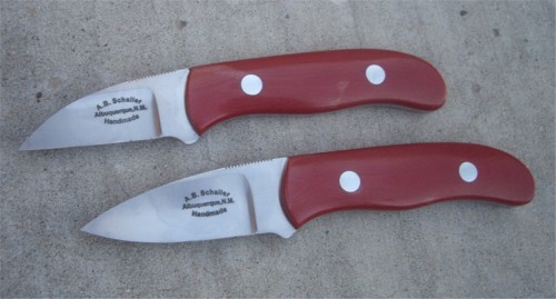

I just finished up two knives for a customer using red linen Micarta. When I leave them in their sheaths for as little as 30 minutes, there are white splotches on the Micarta, almost as if the red dye had leached out. This only occures in a couple of spots on the handle - possibly where the leather is pressed more tightly against the handle than in other areas.
A brisk rub with a fingertip (or better yet, a little mineral oil) restores the color, but when I put the knives back in their sheaths, the same thing happens.
This is a new leather that I haven't used before, but it's from Wickett and Craig, who are spoken highly of in the sheath forums, so I assume the leather is good. I haven't used red Micarta in years because of inconsistent dye jobs and black inclusions, but this was at the request of my customer.
Any ideas?
Thanks!

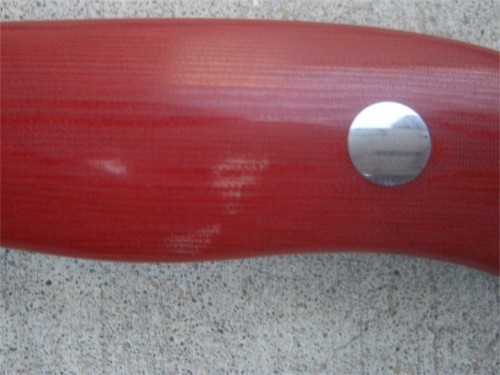

Wierd... I usually take mine to 600 or even 1000 grit so as not to buff it too long. Can you post pics? Does the color come off on a rag when you wipe it down?
-John

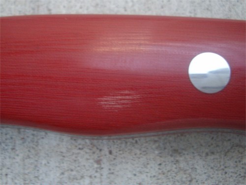

Here are some photos...
Color will not come off on a white rag, no matter how hard I rub - even rubbing with mineral oil. Neither will putting the knives in and out of the sheaths rub the color off. Only leaving them in the sheaths for about a half hour will do it. A light rub with mineral oil will restore the color indefinitely - until I put them back in their sheaths.
I'm stumped...
Did you wax the sheath? Apply a good coat of Sno-Seal to the leather and your problem should disappear.
Those may be spots where you haven't got the polish as good as the other areas. The leather sucks the oil that fills the micro scratches and hides the dull spot. Try this:
Clean with acetone,then re-polish up to 1000 grit, buff well, and make sure there is no spot at all. Insert the handle into the sheath (with no oiling at all) and see what happens.

I have to go with Stacy on this one; this has happened to me before but it's been due to missing some larger scratches along the way for some reason or other. They are hidden by the oil for a time but when absorbed by the sheath then the deeper scratches become more apparent. I think if you repolish those spots they would disappear for good.
Well, I found some Sno-Seal in a local sporting goods store and tried it. It reduced, but didn't eliminate the problem. So I sanded down the white spots with 400 grit (just to take a few thousandths of an inch off, as it seemed these spots were pressing harder on the leather than the rest of the handle) then wet-sanded with 1200 grit and buffed. That took care of the problem!
