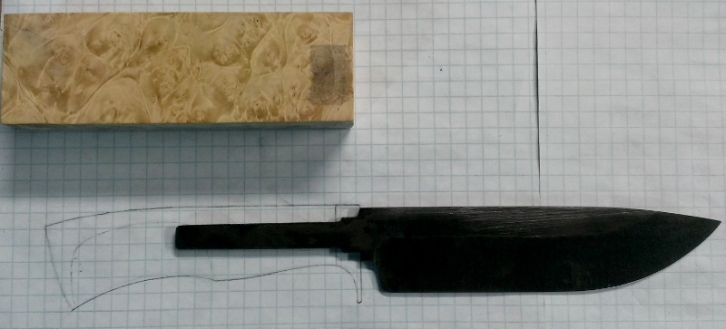

This hunter is my current project, 5.25" blade, 10" OAL (I haven't cleaned up the blade yet from HT):
My question is regarding shaping the back half of the handle. I am flip-flopping between two ways of doing it. I can contour the handle continuously, with only a small bump in the bottom where the handle transitions into the area for the ring and pinky, or I can cup that area out a bit on each side to give a pocket for those fingers to curl into.
If I go with the concave option, should I contour the handle according to option one first, then carve out the concave area? What is the easiest way to do this? I have a foredom (basically a hopped up dremel), so I was thinking a burr might be a good solution there. Does the handle design look solid as far as form meeting function, and also does it seem to mix well with the drop point blade? I think I've got it really close, but I'm not really ready to start cutting yet. I'm working tomorrow, but when I get home I think I will clean up the blade and hopefully start on this one.

Your handle shape looks very nice and should work well with your blade shape. You can start with your "option 1" shape and remove the material or you can cut close to the concave shape and remove material from there. Be careful with motorized tools. They will remove more than you want if you aren't paying close attention to what you're doing. I would suggest cutting close to your concave shape leaving a little meat outside the line. Then go in slowly and carefully with rasps, files and sandpaper. You can work quickly enough with files.

The spine typically looks better with a slight curve to it. I also make my tangs a bit longer. I would have went 2 squares longer into the handle. Your grinds and fit and finish are great, I was really impressed with your first set of knives.
The profile is great and I think the Coke bottle shape is preferable to slab sided. I would use a pin with that tang as it's a bit small and tolerance of fit is likely to have a big influence over the "solidity" of the knife
A solid design that's been chased by A LOT makers for good reason. Regarding the handle contours, I expect you're just going to have to build a few more before you can have enough information to settle the question with any authority. Suggest you go with what feels right on this one (you study and have good instincts IMHO) and it will be a fine knife either way.
A couple of thoughts.
Drop point doesn't always mean limiting the drop to just the point. You are showing about 2" of dropped spine at either end and about 6" of dead straight in the middle. This one is baked at this point, but down the road, draw up the same profile but build in a single subtle contiguous curve, point to heel, and compare with this. I bet it will be worth your time if you are sweating this level of design detail. (Clarity: leave the X,Y exactly as is on your point, guard top and heel and connect them using no straight lines.) Personal choice obviously and you may love it exactly as is - so grain of salt and all that.
I agree that the tang should be considerably longer - especially on a 5"+ working blade. Grinding in some slight proximal taper will help with setting the guard. I would also make the shoulders smaller for a more substantial transition (seeing alignment weirdness in the bottom shoulder but probably just shadows). Goal would be strength; to have more working steel and less guard material at that junction. And a pin or two on the next one would be good. Drill before HT.

Yeah that funkiness in the shoulder is shadow, it is pretty symmetrical in real life. So you're saying just beef up the tang a bit right under that area, then widen out the area that fits into the slot on the guard?
I think I can probably squeeze a bit of extra curve out of this, but maybe as you said, this one is what it is. I think it is reasonably attractive at least, even if not completely refined.

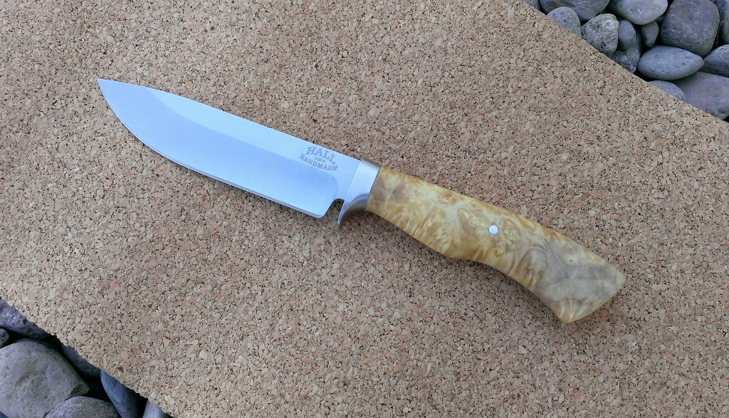

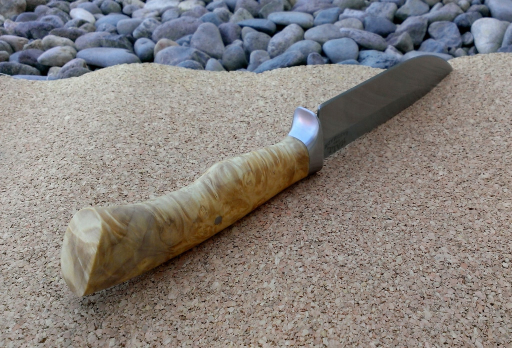

Though I'd check back in with the results. I'm pretty happy with how it came out. I made some slight modifications to my original plan, but the knife turned out pretty much as I envisioned it. I ended up going with a continuous contour. I wanted to make this knife a bit slimmer so it carries nicely, so I didn't really feel like I had enough space to do what I showed in my drawing above. The transition at the swell has a nicely finished corner, but it is a bit hard to see in the pics. The makers mark came out nicely as well. It looks a bit fuzzy in the pics, but it's actually pretty sharp.
I put the blade in between a couple of wet dish sponges to keep it cool, and was able to soften the tip of the tang enough with my mini torch to get a nice cleanly drilled hole for a pin. I went with 5/32" for the pin size, I figured since I wasn't using liners or any other embellishment, a slightly larger pin could add a bit of flair.
As a side note, getting decent pictures of knives is probably harder than making them.
edit: Those shadows at the guard/handle joint aren't really there, it's just the lighting. I went a little crazy making sure that joint was dead smooth.

Beautiful knife Mr. Hall. Agree with all the above. Proportions, lines, ergos, materials, grinds, f&f - all look excellent from here.
My only minor criticism would be aimed at the size/scale of your mark. I remember your guy said 0.75" was the limit, but ??? Should be an easy fix next order. Or PM me and I'll hook you up with some folks that will get it done right and fast.
Also it seems to me that this level of fit and finish would be worthy of hand finished bevels. But...your grinds are sharp and clean so they look great as is.
You have good instincts and the patience and skill to back them up. So go build another one already!

About the only place I could make a suggestion would be the guard tip. It looks a bit flat/blunt, making the guard have a rectangular profile. Perhaps a bit more taper to a rounded point would have more flow. The overall guard profile should be somewhat egg shaped or trapezoidal.
I see what you are saying. I think I could still reprofile it if I taped the blade up carefully. This was my first guard with compound curves, I think I ended up focusing on getting that right and didn't pay enough attention to the overall profile. I noticed it looked a little blocky in that last pic.
