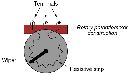

Hey guys,
So I went to sand off a little scale on my platen so I could put a ceramic liner on it and finally get to grinding. The grinder and VFD are all hooked up and had been running/operating fine.
The VFD is a Teco FM50. I got the 10k speed pot from Radio Shack and like I said it was working fine. Now it only stays at 10Hz. I have function 6 (upper limit) set to 60Hz and function 11 set to 1 for a speed pot input. Now I can't control motor speed with the speed pot. I changed function 11 back to 0 for keypad control and that works fine. None of the wiring was touched and the connections to the speed pot were soldered. No loose wire on the vfd end either. Also, everything was cooled down and hadn't been run in a little while.
So, is the pot bad? Can you test via impedance or something of the sort?
Any suggestions? Other than just getting a new one.
Thanks!
Nathan

There are 3 leads on the pot.
If you installed on the 2 outside leads, you eliminated the wiper contact and turned a variable resistor into a fixed 10k resistor.
Which would put you on lowst speed.
You want to use 2 of them, but not the outside two.
The left 2, or the right 2.
If you have an ohm meter,
turn full left = counter clockwise and pick the 2 leads that give max ie 10 k ohms for lowest speed
turn full right = clockwise and pick the 2 leads that give minimum or zeroish ohms.
These 2 tests should give you the same 2 leads.

These VFD's actually use all 3 poles Count.
+10v, wiper, and a common.
+10V and common are the two outsides, with the wiper naturally being the center.
If the speed varies in the wrong direction, swap the 2 outside wires.

Not FOS, but just not correct in this instance. On all VFD devices I have used, the three wires are as Fellhoeter said.
The potentiometer acts as a resistor with a center tap. The tap ( wiper) gives a refference voltage which sets the speed program. Without the winding fully in the curcuit, it won't work.
If all three wires are connected correctly, I would suspect a bad potentiometer.

Thanks for the replies guys.
It was previously hooked up with the speed pot and working flawlessly.
It is not grounded.
It just started this out of the blue yesterday. I just got home and haven't had a chance to look at it yet but I will be checking the resistance. I have a feeling that the pot is fried and I will just have to buy a new one.

I had done lots of research prior to hooking everything up and i was the linear taper.
I was passing a Radio Shack on the way home and decided to just pick up a new one considering they are only $3.
Hooked the new one up and working great, reconnected the old one and nothing. So it was busted.
