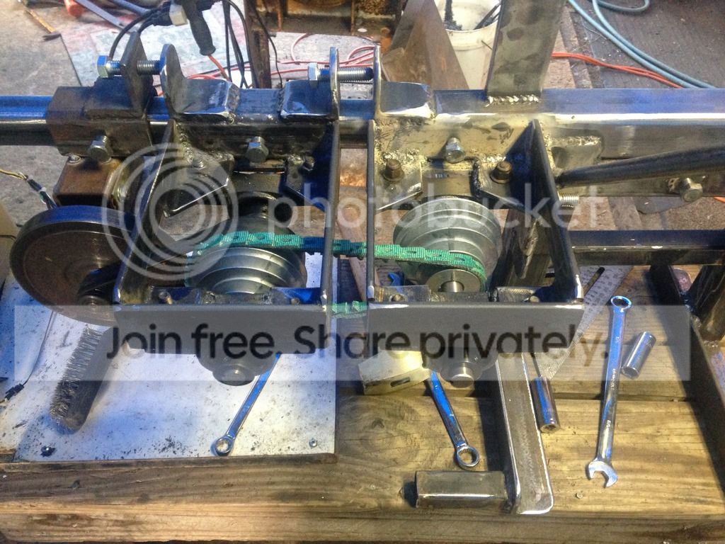

If anyone is good with this can you verify my calculations are correct?
Motor max RPM: 5600
Final pulley ratio is 1 to 1.625 (motor spins 1.625 times for every one of the belt drive pulley) Verified by balance drill mark on motor pullet at 12 o'clock and keyway on final shaft at 12 o'clock turned motor over till final drive was back at 12 o'clock and the motor pulley went around one full revolution and then to about the 7:30 position. So I'm calling that 1 5/8 turns or 1.625.
Final pulley max RPM: 3446.15 (5600 RPM / 1.625 pulley ratio)
4" Belt drive wheel circumference: 12 9/16" or 12.566" or 1.04'
Surface feet per minute: 3608.693 (3446.15 RPM x 12.566" / 12)
Edit: If correct how is this compared to other grinders?
