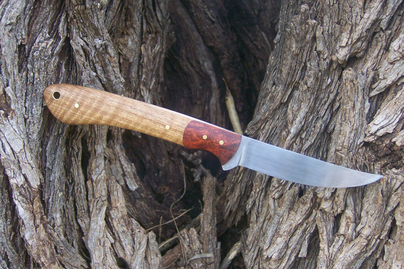

I do that kind of handle all the time. Often I'll just use epoxy and dovetail the joint. I usually put two pins per piece, but that's just me. As far as the glue, clean everything up good with acetone and use epoxy. I wouldn't trust CA for attaching handles to a knife.
Your mockup looks fine. Use the strongest epoxy you have available. G-flex or T-88 is the glue for such tasks.
As Jason said, dovetail angling the joint makes it stronger and better looking. About 20-30° works well. One advantage of this is that when the handle is rounded, it makes the joint appear as a curve ( see Jason's second photo)
In some cases, placing the joint at a diagonal (as opposed to perpendicular) to the line of the handle also looks good.

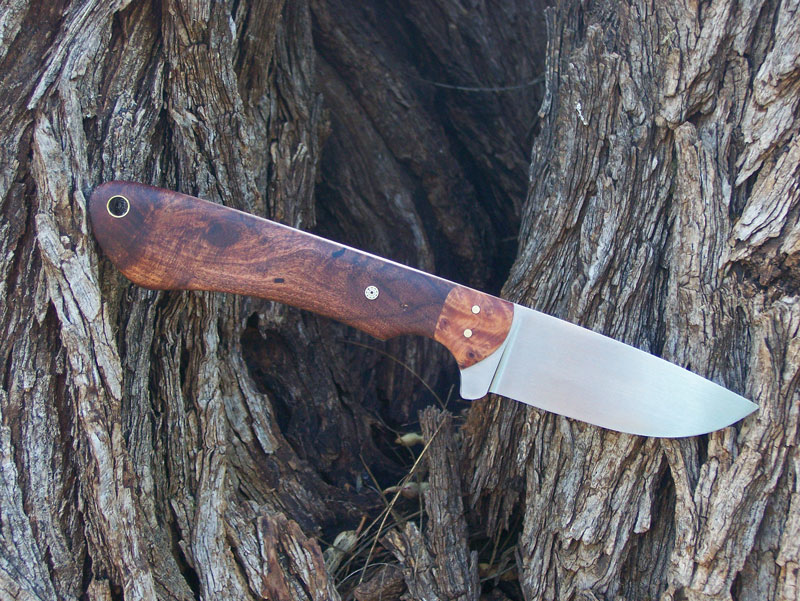

So, I promised I would post pics once I had these scales finished. I'm pretty darn happy with the results, I forgot how sparkly the birdseye was. It was a couple of sad looking little scraps too, never would have guessed. I sold the guitar this wood was on a few years ago.
I did a bit of rework after these pics, removed a couple small scratches, fixed the finish on the heel of the handle, and worked on the crown of the handle a bit in relation to the blade. I didn't peen one side of the pin quite enough so I ended up with a small shadow. :(

Thanks!
Grizzled, that is indeed a miter joint. I'm not really sure why we're calling a dovetail :)
The front is actually not a square butt, it has a gentle crown to it. There are quite a few different ways to treat that area. Sometimes I've seen people do heavy rounding, or a large chamfer, or a "pinch", which is a concave taper.
After I read your comment, I looked at my photos and it does look a bit abrupt. I took a couple more photos showing how it looks from a better angle:
