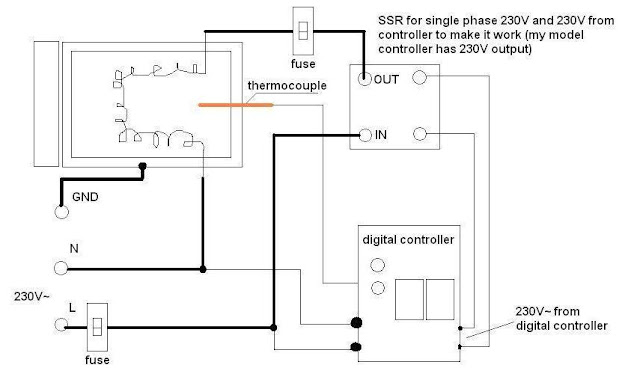

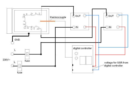

If you use SSR - Solid state relay - here is a scetch for 220V: - two lines
And for 110V one line and zero

CAUTION - The schematic shown is for EUROPEAN wiring. Do not hook up US 220VAC the same way.
