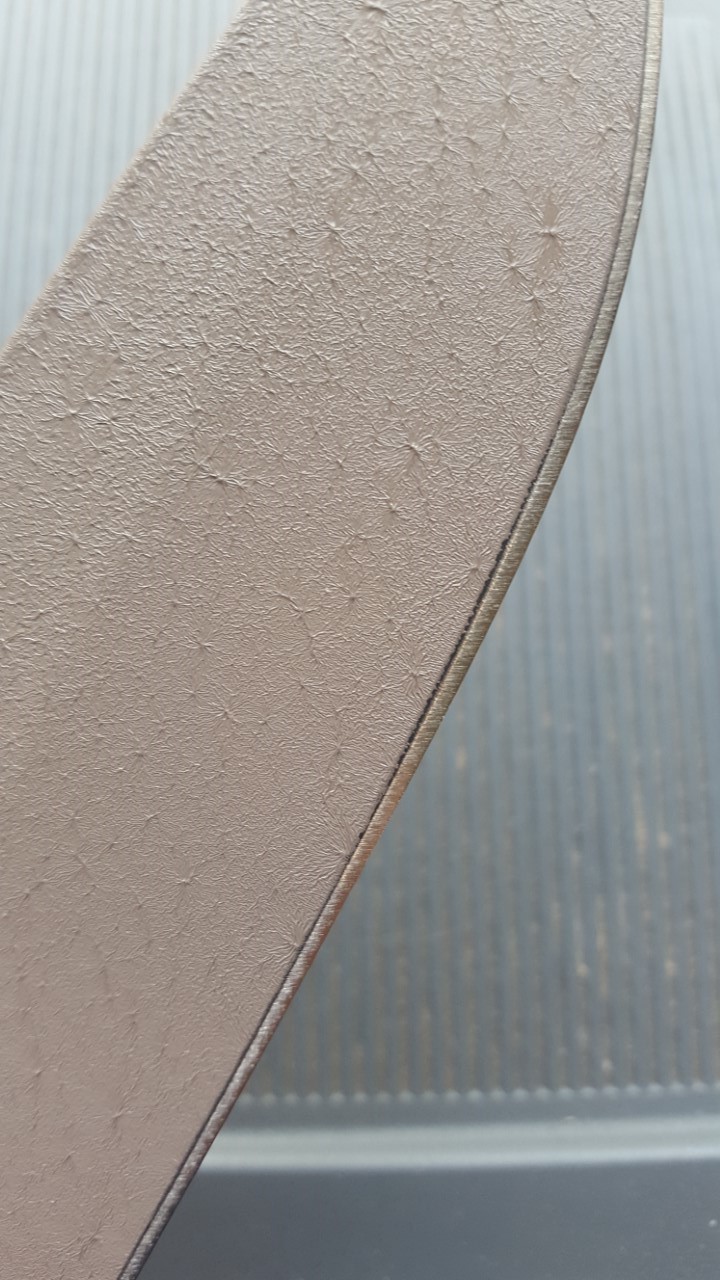

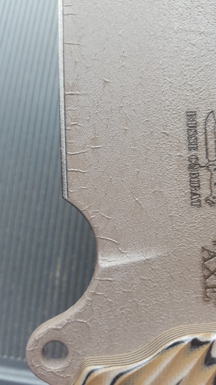

Can someone tell me what on earth this is on my blade?
Almost across the entire length of the edge between the edge and the coating is a dark black line.
Please see the photos:
It might be polishing compound where the coating was sharpened off. Just speculating.

Just decarb mate
The knives are coated then sharpened so if you imagine the grinder hitting that now edge and it just nicked the primary grind, removing that tiny bit of paint, leaving the decarb underneath.
Nothing to be worried about but if you want to get rid of it - use your knife batoning or knock the shoulders off the edge by sharpening

Thanks guys, both possibilities make sense.
I gave it a clean but it didnt come off. I was hoping it was sharpie haha.
But it must be the decarb.
It doesnt bother me to look at but ive read that the decarb is very prone to rust? Ill probably baton it off when i get a chance. But for now, will mineral oil suffice?

Yep, just the decarb layer exposed slightly. You see this more prominently with the lighter colored coatings when the decarb is heavier than usual.
ETA - One side of my BT6 had the heaviest, toughest decarb layer I've come across.

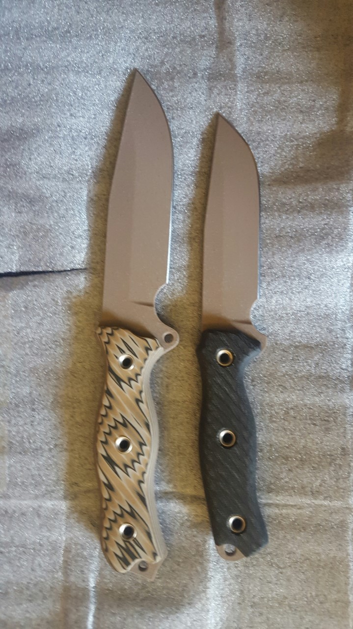

Share full pix of that puppy! :pig:
Were you able to get it off? If so, how did you go about it?
Or did you just leave it and pay no attention to it?
I stripped that BT6, and have most of the decarb removed. Still need to finish it. Scotchbrite belts and sheets, but I need to order more belts.
