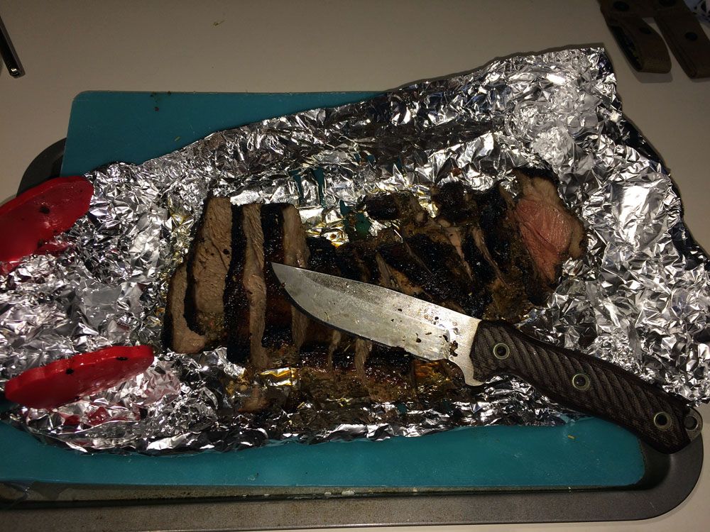

Yep, what he said. You can also try, but be real careful. Take some 800 grit wet dry sand paper and highly pull across that spot without (1) slicing off your fingers and (2) not messing up the edge. Its going to be tedious and a slow process but at least you will have polished the edge and gotten rid of the that line. Now please note, you can not get into the finish or you will just expose more of it. Or just leave it or strip it completely and remove the decarb to expose that INFI beauty like she should be. After stripping a blade, I tell you that is decarb and not much to worry about.
Just decarb mate
The knives are coated then sharpened so if you imagine the grinder hitting that now edge and it just nicked the primary grind, removing that tiny bit of paint, leaving the decarb underneath.
Nothing to be worried about but if you want to get rid of it - use your knife batoning or knock the shoulders off the edge by sharpening
Thanks for the advice, appreciate it.
I am going to leave it for now and maybe strip it in the future. Or if the decab starts rusting ill definitely strip it all.
In terms of slicing my finger, i already did that :D whoops.
I was trying to clean it off (hoping it was a sharpie mark) with a towel and it sliced through the towel and my finger. At least beef sharpened it really well
Some one already said it, but it is likely from the final pass on edge while sharpening.
I've got some on my WTF. I thought it was buffing compound from a pass on a buffing wheel.
All my stripped info had a layer of grey finish underneath. But not really de carb, I don't believe, because I've never had rust on any.
The only really rust prone INFI was the initial comp finish blades, with real decarb. That true decarb usted harr and fast, but it was prettybeasy to get rid of from reports. Different then the dark finish under the coatings though.
No need for any oil on INFI, unless you are on the ocean. In my use, including swimming, canoeing for days, rafting, fishing, it has been stainless.

It looks like I have it on mine, too. I'll just beat it off. Not gonna strip it. After the horrid experience I'm having with a SAR 5 that I stripped, I'm done stripping. I'll just beat and bEat, and if it wears off, good. It isn't worth my time to worry about it. Bought it as a user.
I wouldn't have even noticed it if you hadn't posted this. Good eye.
Really, what happened with your stripped SAR 5?
I am not going to bother stripping mine either, like you said its hard to see unless you look for it.
I just want to make sure it wont cause any rust issues because decarb is suppose to be very rust prone. Im going to leave it unprotected for a while and see what happens
If its fine...awesome.
If it starts to rust....well i am not sure.
If you get time to use yours anytime soon, please let me know how it goes :)
I wont be able to use mine properly (besides basic housework) anytime soon.
Cheers!
Stop worrying. It's a knife. Just use it.
..... pretty much the best advice so far. Please mate, stop loosing sleep over rust and corrosion on your blades. Busse knives in SR101/INFI and several other steels have been around for many many years and have no history of rushing away to dust or being damaged by corrosion (especially while sitting on your bedside table ;) ). It is just not worth the apparent concern it is causing you.
The "de-carb" lay will corrode up to a nice red if not removed after a blade is stripped but it is just a layer, some steel wool and some oil and it is gone and the INFI under knows no difference. One of my stripper RMDs .... (here on kitchen duty)...
.... gets wiped off after use and lays around the kitchen or dining room un-oiled year round with no issues at all.
Please....just don't sweat Mate, enjoy the knives without the worry.

My point my friend you do appear to be overly concern about corrosion on both your SR101 and now the INFI, what we are trying, repeatedly, to do is assure you that this is NOT something you need to be worried about, worry spoils the fun... ;) Over the few year I have been here many people have been down the same path and asked the same questions. So the answers you have been getting are well and truly based in fact not supposition or internet gibberish. Love and behold your new toys mate... !!
Thanks Andy. But you have reassured me now and its no longer a concern after reading your points and experience. Worry does spoil the fun but my concerns have been answered, so only fun times ahead now. Cheers

It's definitely rust. If INFI rusts under the coating, that's bad news. It'll eat through the blade before you can say 'Captain Feathersword likes to play the tambourine', and unfortunately this kind of rust is due user neglect and improper maintenance therefore completely voiding the warranty. What one earth did you do to get rust UNDER the coating?
:D
Seriously, I reckon its a discolouring of the paint from when the knife has been sharpened and its just burned the edge of the paint slightly.
