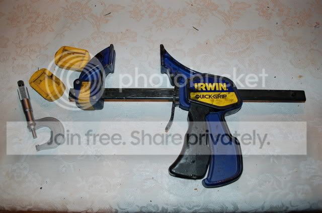

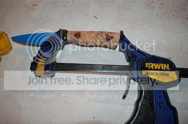

Here is the first.
I saw this Idea some where and I really like the way it works in clamping hidden tang knives when gluing or drilling. I have used it at least 50 Times this way.
1
Standard Quick Clamp
2
remove protective pads
3
Slot end
4
Install to work on/ glue/ drill knife
