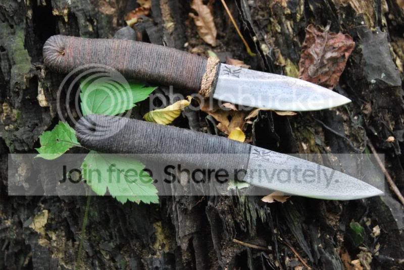

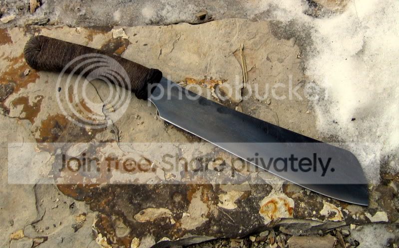

I have done many hemp wraps... shoot me a pm if this is the style you are looking for...
I have also done quite a few hemp wraps. I spray the thing with Shellac whilst wrapping it, and then spray it more after it is done. I have taken to 'capping off' the ends with wetted-out carbon fiber tape, and then soak the hemp in a thin wood restoring epoxy.
