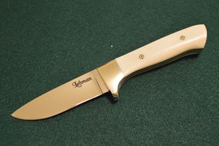

Here are a few knives i finished in August.
Feb 6, 2010
1,427
Here are a few knives I just finished. Larry
Likewise!! Larry, what is the blade length on that one?
My thanks to every one for the kind comments. The harpoon point knife is 8 1/2 inches with a 4 inch blade from the center of the bolsters to the tip. I have to measure my knives to know their length . I draw them on printer paper with a French curve and a circle template and trace the paper patterns onto my steel, CPM 154 in this case. When I grind my knives I hold them up to the sky to see what the profile looks like and grind them to a pleasant shape. I threw away my first blank because the swedge ground down further than I wanted the blade to finish so on this one I exaggerated the swedge when profiling and ground down to the shape I wanted just before heat treat. I tapered the tang on a Travis Wuertz surface grinding attachment. I make "one of a kind " knives but usually keep a copy of my drawings if I ever want to use the basic blade shape again. This is probably more than anyone wants to know but that's how I do it. Larry

They are cool, Larry, just darn cool! Camel bone second from the top? Working on two with camel obne myself right now.
Dave, Yes it is camel bone. It usually looks really like ivory when finished. Here is another one I kept for myself. The photo is not very good though. Larry
