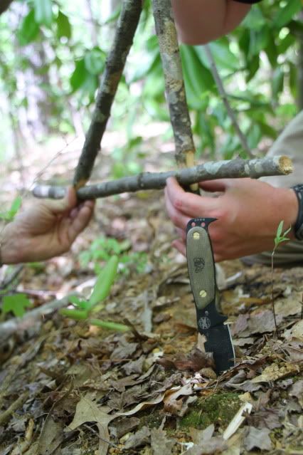

First attempt at a figure 4 deadfall trap, all cut and trimmed with the HEST

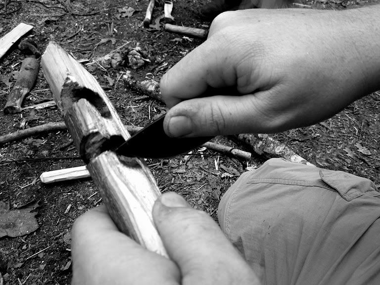

Fashioning and using a bow drill

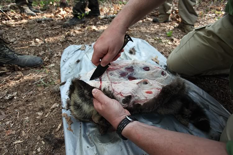

Skinning a raccoon.

What kind of wood is that you are batoning the notch in for the hearth board?
