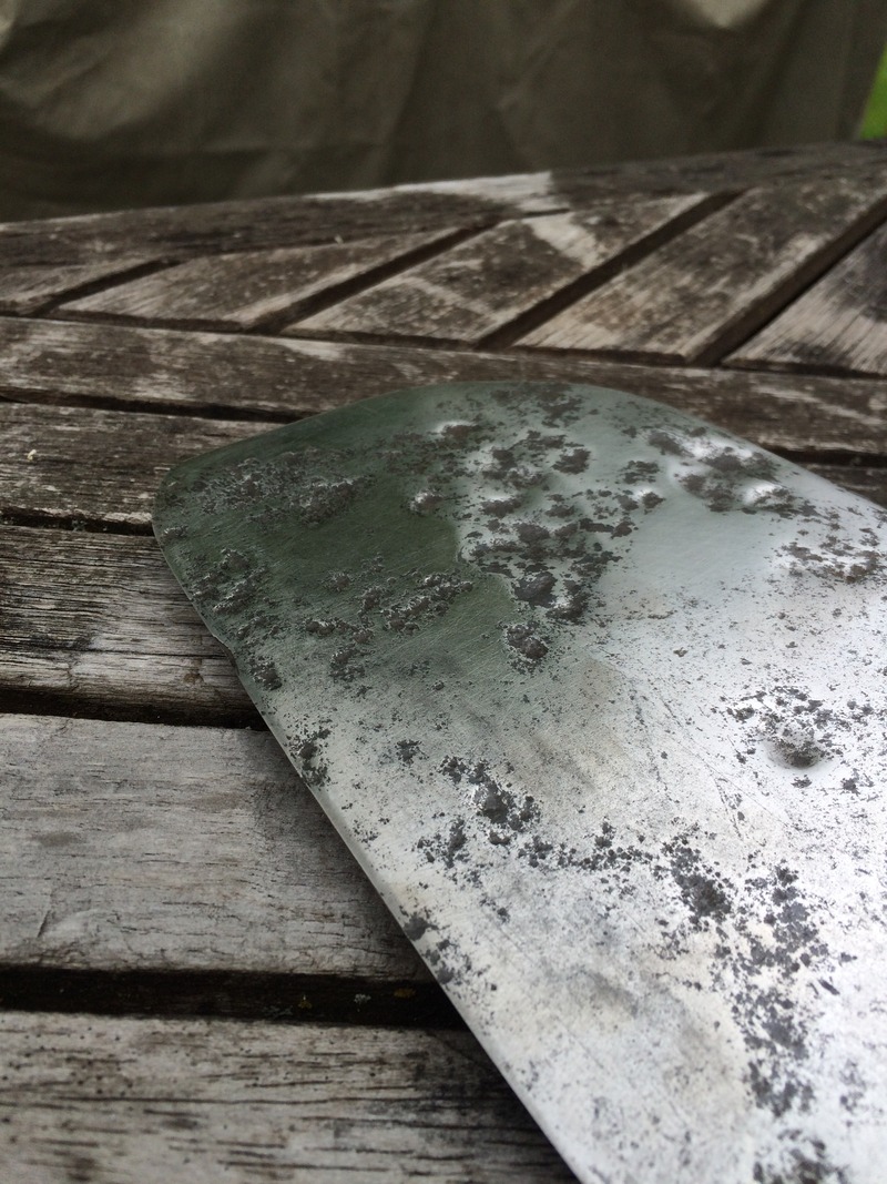

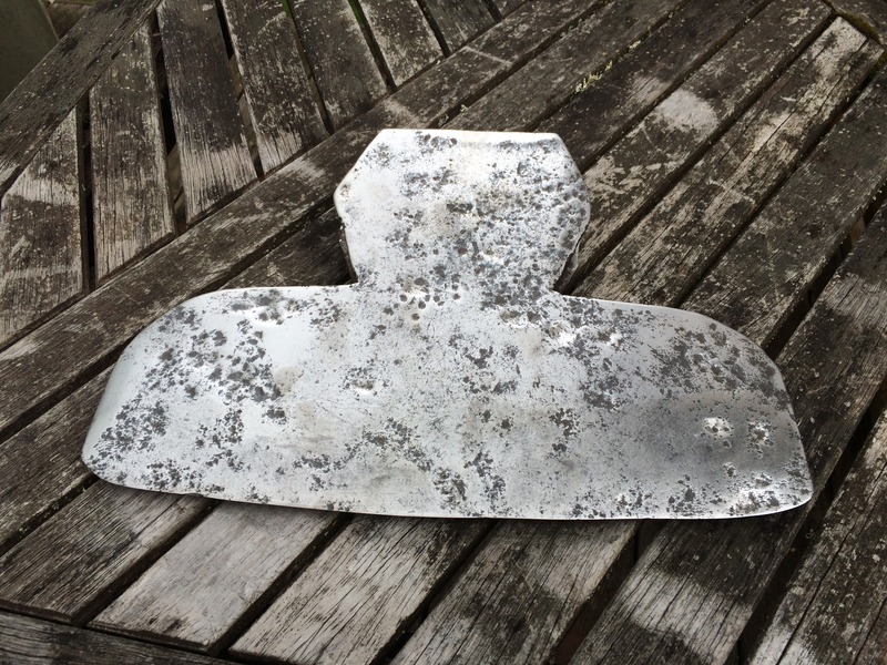

Little update on this thing. In order to make it flat, I would have lost too much metal.

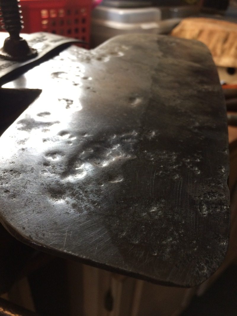

So… I flat-filed it hard to make flat and smooth what is left of the original surface/plane. I tried to clean out and sand the heavy pitting as well. I kind of figured if it can’t be totally flat then maybe I can help it out by sanding out the pitting so there weren’t sharp transitions. It feels smooth but not flat with your palm on it.

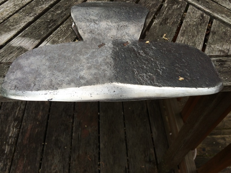

I think the bevel is all one angle. Tried to match the toe shape to the existing one (it seemed right, more or less). There are a couple of spots on the edge I plan work out before hanging. I've actually done some of it since I took these pictures.
I’m not sure what else I can to the back/cutting face to get it looking more like an intact hewing head besides sand it to a grit or two higher to remove some of the scratches. Input is great.
I realize it’s going to be a user but that doesn’t mean I will shortcut it – I like having something in the vise I figure.

Nice work on that old workhorse, by the way! Looking healthy and hungry for hewing work again.
