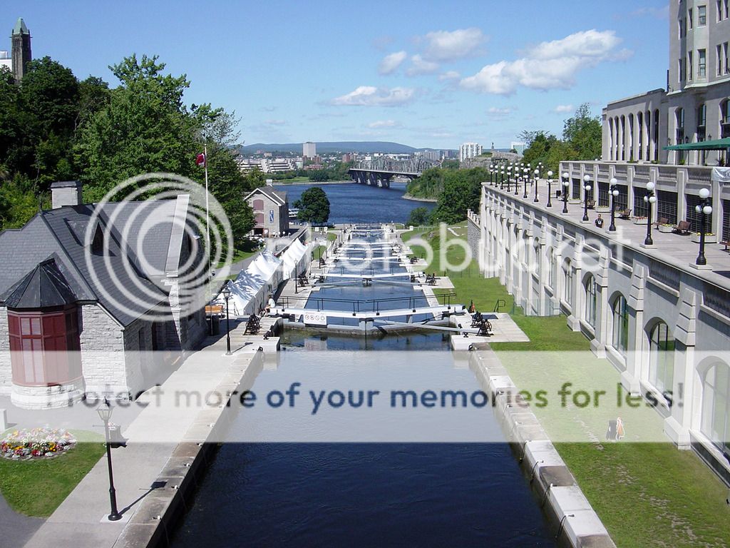

After the War of 1812 (between 1826 and 1832) the Brits dug and built the 120 mile long Rideau Canal from Ottawa to Kingston. Squared timbers were used as removable stop logs in the various dams and to build the large water doors at every lock station. These easy to service wooden structures are still in use and 12 x 12 saw-milled Douglas Fir is used nowadays. Pic below is of the locks in Ottawa adjacent to Parliament Hill, looking out towards Gatineau (the lumber town formerly known as Hull), Quebec. The beauty of wooden stop logs is they swell when they're wet which makes for a good seal once they're fitted in place.
