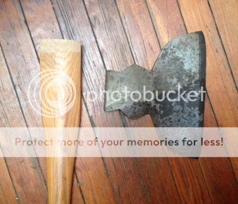

Just got this offset handle from hickory handle store and am very pleased with it. The head needs a little more work. I just got an electrolysis station set up, so it'll be going into that. It's already had a couple days in a vinegar bath, you can see the line showing what was submerged and what wasn't (it wouldn't all fit in the bucket). I'll get some more photos up in this thread soon.
The handle came with an overly large eye section so you can carve it for either left-handed offset, or right-handed offset. So it's a bit more of a project than the usual rehang. Which is good. I'm liking the challenge. Anyone else have experience with rehanging a hewing axe? Things to look out for?
Don't cut the kerf in the handle until you can fit the handle in the eye all the way. The kerf should be open when you go to drive the wedge.
With that handle, you're gonna want to narrow the handle. The tongue (part that goes in the eye) should be pretty much the widest part, except for a little ledge for the head to butt up against. If the handle is too wide, you won't be able to get your hand behind the axe head for fine work choking up on the handle.
Also, that head has lugs that are gonna make fitting difficult. Make sure you account for them when shaping the handle. Similar to hanging a Jersey pattern axe head.

I cross-wedged mine to expand the eye wood in both directions.
Keep in mind that with a curved haft the head will apply some rotational force on the haft because the weight is to one side. You'll have to counteract that with your grip. So having a less round grip helps. Make the grip narrow and tall so it's easier to apply the counter-rotational force.

Three. Short wedge down the center first. Then the main wedge split in two. I waited until I had the haft through the eye before I chose the kerf locations. I wanted the center wedge to line up on the peak of the axe head.
