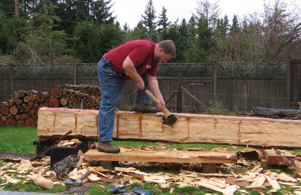

Yea, mine too. I posted this video of some axe work. Here is a screen shot from that video:
Aa_atgzr_4WbT3xAHaxnEU-15OQsy8hpL2_YfJrKTXqh9YDt-LRsl6525FoeaXhSpvob2f07RICf2Oz0EOnNHVvGyBkxy-vv0RaJYNzlFrlueXB-n6TJkCWy_8e3yQptI_hcHjlsdBEfL-axShQpnnLkw9umDV6lDgFoaWOgx3HvNj8xxmDjNW-znzZ1M70Q5mFVlr0b-PTatzY8M8p6CoFqN_oclm3ykxIXf_znaYdPWwunI2OAxhBDnE-PXhCDoWWVYFDuankmIPeaw9_sXRh6UBhUy2YwoffvKIt3NfiamBHFr0SXIu8LwLSJTtWxClDsZZInBPYytMbbNy-B6ipG_1GE1IO_c329mGf7V2I9JOrXrp8b8bfmOmrghAtASGDkVov1ADtPJW_9BJkBLjq7nGUL9tBT0GbGUEiTPyr9s1cwEtSDQmxuOS_hp-h3OM08DiKP0LQ6Qgkc8ERXNeHqIdWQm-SYqfcpuZY523QySxMjARyszzBLR9Y5EW9pCsnm9OsyCKoeogAYhSVVEc6tkKc6gAnQx08MuwUVDeg=w537-h422-no
One thing I noticed is that the log is held up higher than I've normally seen in hewing pictures and videos. The log is usually seen just off the ground. Sometimes the hewers/hackers are actually standing on top of the log. In the above picture the guy on the left is bent at the waist, but the guy on the right is standing straight up.

For some reason, I've noticed that having one leg up like that helps. Working like the first guy kills me.
It's the same when prepping food in the kitchen, like cutting up a lot of meat/onions/peppers/ect. Open a cabinet and put one foot up on the first shelf and the back strain is reduced immediately and by quite a bit.
