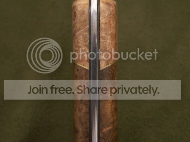

And I owe you a pic. It is a rescale job, redwood burl and maple burl. The pic blows, the camera was giving me fits trying to get it set. I have to use it on manual mode cause the point and click settings blow too. The knife has dust on it.

Looks good :thumbup: Once I have some decent scrap pieces I plan on doing something with 2 different woods. I was never really sure about the best way to go about doing them without using pins in the "bolster" part of it.
What do you have dividing the 2 scales on there?

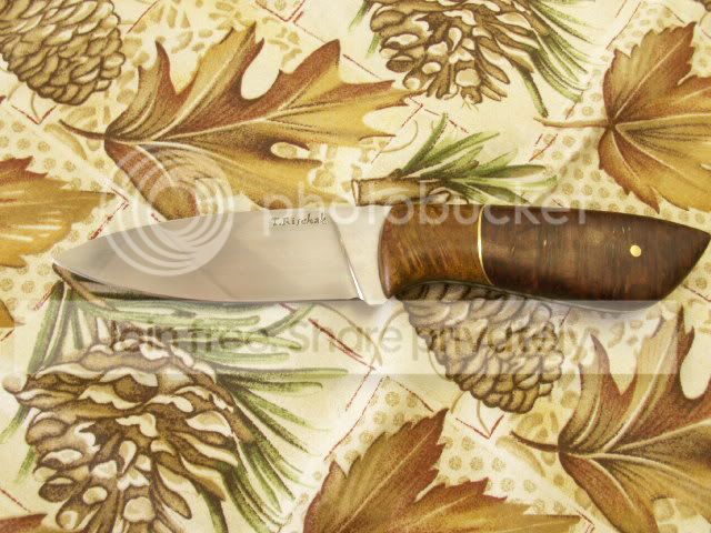

The handle is full of hidden pins that only go halfway through the thickness of the material. 5 total pins including the shown one. The spacer is .020 brass sheet. That one pin was not even supposed to be shown but I lost control of the material drilling one side and it ended up going all the way through. Lucky me it was the one in the butt of the knife. I should have taken another pic, the joint is dovetailed (that's why the joint looks rounded) so whichever side is not locked in has the potential to separate if any serious prying load is put on it. That is why I had to fix it in the first place. I need to experiment with putting a 1/16 pin in stabilizing the joint. Here is a pic of the original, the joint is done the same way on the fix.
Wow, those two woods complement each other very well. Great job!
Thanks, I always liked the lighter wood up front with darker in the back, but IMO you have to use all burl wood, or all curly, having curly up front and burl in the back doesn't look quite right. It did take some looking to find the right pair of scales for purchase. Oh well. This is the last time I use natural materials for a long time. I have to work on my process more before I start trying to use expensive material that can move. It's embarrassing when you get a knife back cause something moved.
