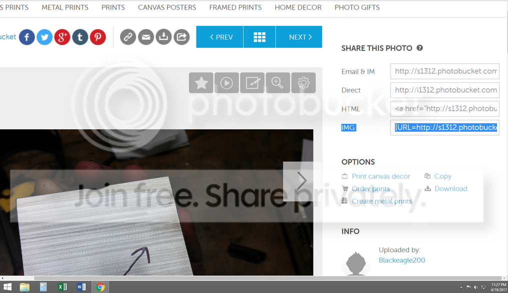

I believe it is in the stickies. Basically you make an account with a photo sharing site like IMGUR or Photobucket and you upload your photos onto your account there. When you look at one of your pictures on the site, there will be a few links/codes you can copy and paste into your message. Copy the one that says "IMG" next to it and paste it into your message here.
Here is a picture of what it will pretty much look like (In this case, I used Photobucket). I highlighted the link you need to copy and paste-
thanks man i looked all over for how to post pictures but now i cant figure out how to post threads or anything i posted this thread monday but i forgot what i did lol
