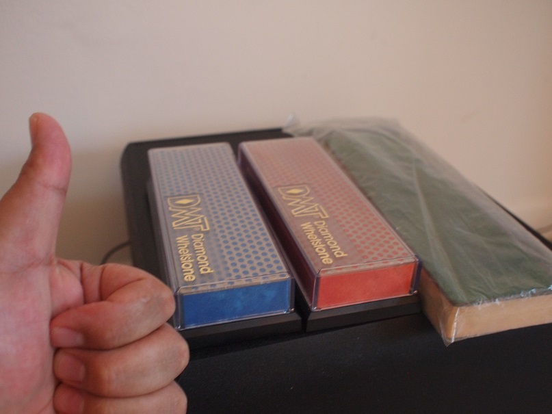

6 inch Dmt red and blue and a strop.
That is all I need to compliment my sharpmaker.
