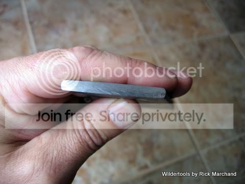

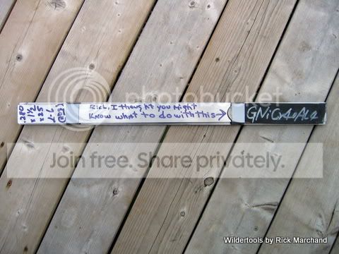

Lookie what I got gifted in the mail today from a madman in Jersey...
Look familiar?
Awesome! Grind that stuff with a sharp belt! Mine turned out as a pretty darn good blade "steel"... I'll be interested to see what you do with it.
it looks like one of the free test sample xia'chu sent a year ago across the sea lol. that funny hand writing looked formilar. did you just receive it or was it from someone else?
btw, be careful when you do the grinding. this thing do not turn in color even if the temperature hit 1000f +. and it cools pretty slow. many people got their finger burnt during the grind lol.
I just got it yesterday from Aldo along with two bars of L-6. How does he stay in business giving away all his steel?... not that I'm complaining.;) What a guy.
