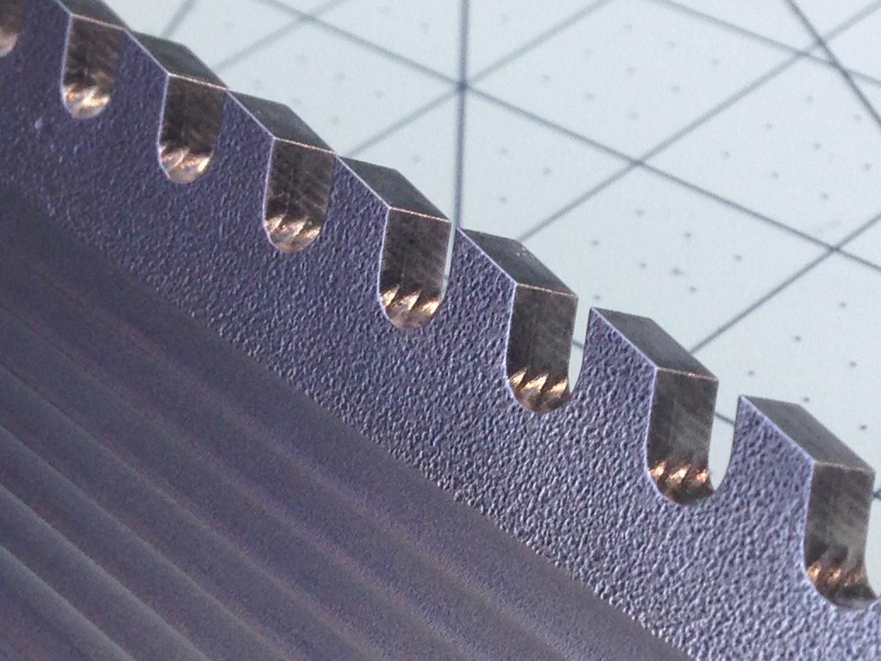

BattleSaw was my most enjoyable strip job ever...posed some unique challenges.

This is what was hiding beneath the coating of this Boss Street. :)
IMG_2667.JPG IMG_2671.JPG IMG_2672.JPG IMG_2674.JPG IMG_2675.JPG IMG_2676.JPG IMG_2667.JPGIMG_2673.JPG
