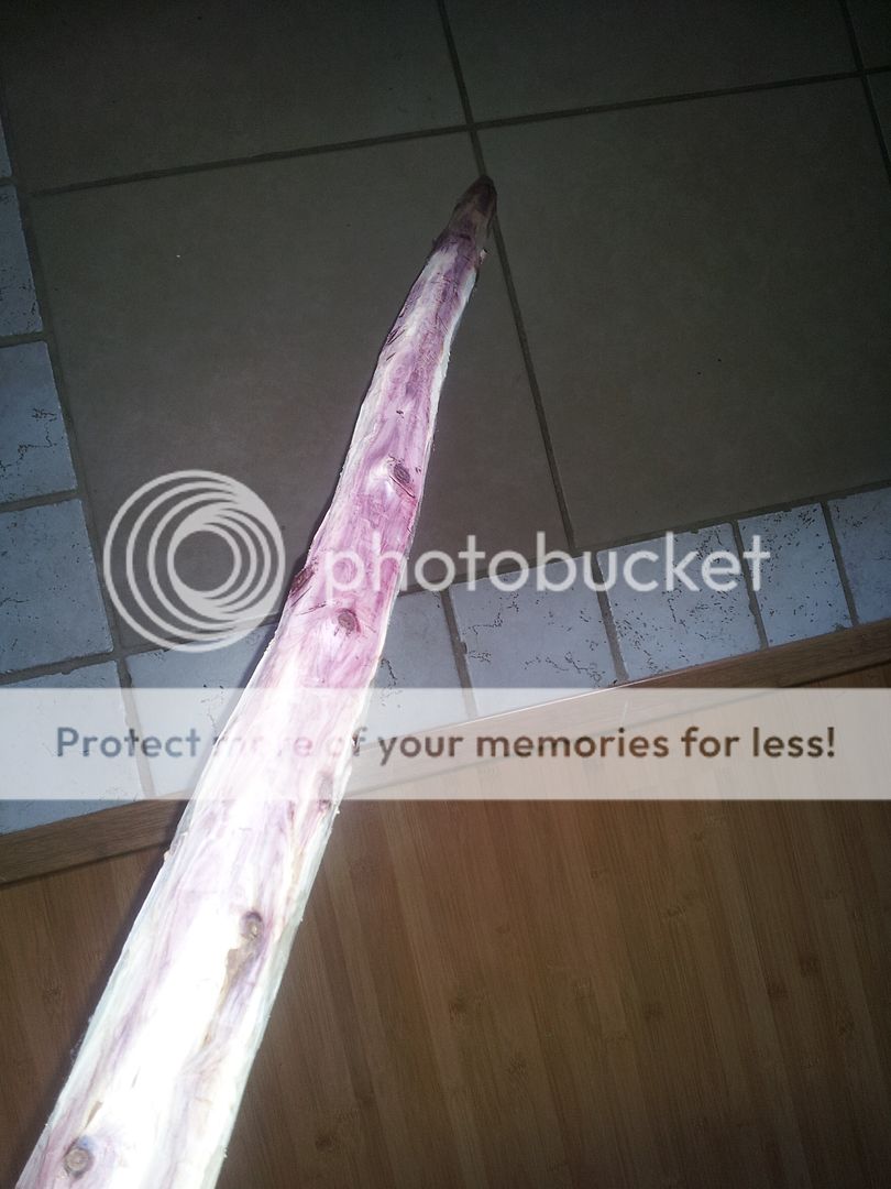

Speaking of Cedar, I was out in Tunic Trace a couple weekends ago and came across some Cedar that had purple heart wood. Is this something any of you have seen before? I've never come across it and never worked with anything like it in the past.
I ended up cutting 3 sections of the fallen branch. Making a couple of staffs with it....
Here it is:
