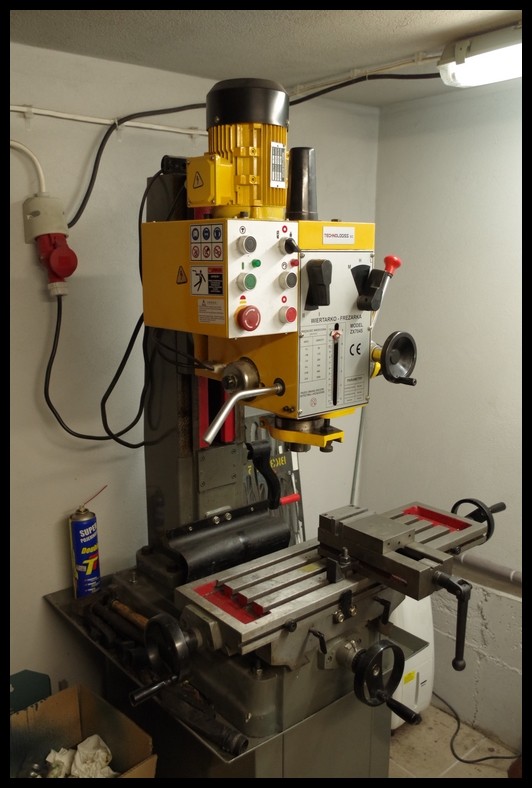

My mill would be ok for folder work ?
Technologiss ZX7045 ( aka ZAY7045 / RF45)
