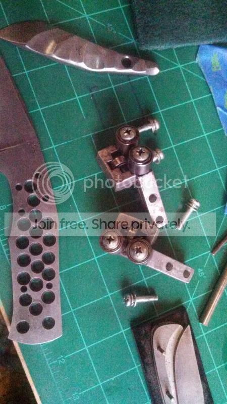

I've a broken pair of bearing, do anyone know where I can buy replacements?
There are 2 pairs of bearings, one pair on each side of the cutting window. I want to replace both pairs.
Thanks.
I doubt the manufacturer sells parts. Have you tried measuring the old ones and looking thru McMaster-Carr? I'm sure they're something common.
Quite a few ppl here use HF portaband, just hopping that I am not the first one has to replace these bearing. Measure part -> McMaster-Carr would be my last resort route - good rec, thx.
Call HF. I own a HF compressor and when the pressure regulator failed, they sold me a replacement at a very good p rice
My motor just went out on mine. I will mail you the bearings off of mine if you want them. PM me your address and I will get them in the mail.
I think this is what you need. I mailed them off this morning. It should be there by Tuesday. Glad I could help.

I had a look for those wide ones,
None available from HF
They are available, from bearing suppliers but special size, special order and I think one or two pair was the price of a new saw
I can't remember the sizes, but metric not inch
The narrow ones were the same inner and outer diameter, standard metric sizes- cheap china bearings available.
It's possible you could double them up with a shim washer in the middle.

Yes, those bearing parts look identical to mine. a xmas present, appreciated :thumbup:
You are right, 4 precision shielded bearings would cost close to $50 (@McMaster-Carr). night man save my day!

Did you actually manage to break them somehow, or did they simply wear out with extended use?
One day, I noticed some weird noise, one bearing shield broken exposed ball bearings. So I rotated that one away. Well, the one across from the broken one also start to noisily wobble. I've this saw for over a year, maybe cut 200-250 blanks total. Hopefully I can use it for another 100 before it kicks the bucket.

Wow yeah, much more reasonable pricing. Didn't see right wid/length spec but I could double stack 2 thin together.

I received bearings from night man -> exact matched. Again, thanks!
