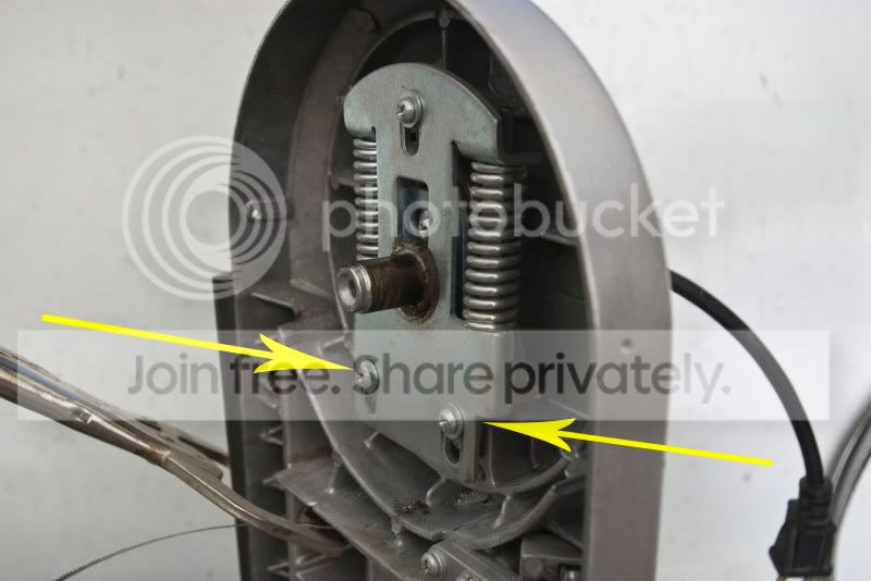

I bought a HF porta-band about 2 1/2 years ago. I had the same problem at first and ended up shimming the tension adjuster. The blade as it came would not run up against the ball bearing guides. After I shimmed the problem was solved. I must say though that the speed control trigger shot craps. I run it with out and have it plugged into a outlet strip and I turn it off and on at the strip.

Frank,
If you need me to, I would be happy to take a picture of my HF and where I installed the shims.

Ken that would be great! I went out there to look but didn't really know what I was looking for. Thanks.
-frank
Frank,
In this picture I have removed the top wheel,(metric Allen wrench). You want to place the washers BETWEEN the body casting. and the heavy sheet metal plate with the springs. You need to try a few different thickness washers. I think I ended up with about .040. Place one behind the screws with the yellow arrows, not the top center one. In effect what this does is track the blade toward the frame and against the tracking bearings.
