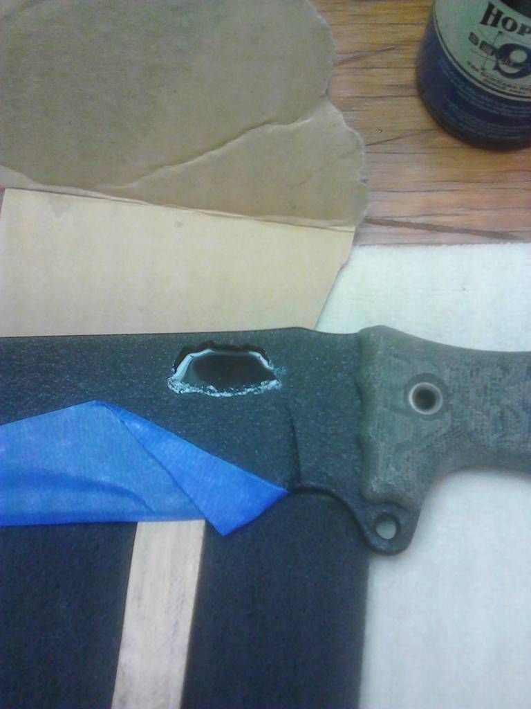

Considering stripping the blade. The knife was recently re coated and re handled by Busse. My questions are: Should I strip it at all,,? Good candidate? Anything I need to look for because its a re coat?

I would strip it if you want. It's a box of chocolates under the coating. It could be smooth as an le or full of grind marks or decarb. It is always more work than you think.
Best suggestion, go to Lowe's and buy citristrip and a flexible 1"scrapper. The flexible ones don't scratch the knife as you can't flex them top disarray the coating from blade. Cover the knife with the stripper and wait like an hour. That's enough time for the coating to come off easier

1. Etch the logo before you strip-- it's the only way it can be done! I don't think you're stupid or anything like that but it just seems like you're full speed ahead with the Citristrip.
2. Decarb is a layer/treatment that is applied to help the paint adhere to the INFI-- otherwise it would just slide off like a stocking. Removing it is the most labor intensive segment of the whole process. It has to be sanded off with sandpaper or scotchbrite (my personal choice).

If is the real deal original 1/400 HHFSH, then it will be ugly when stripped. The spine on mine is all rough from the laser (my guess) cut.
If it is one of the newer FSH that people call HHFSH (whole nuther story) then it might not look as bad naked.
Decarb is NOT a layer or treatment applied, it is the result of the heat treat process. At the high temperatures, the some of carbon in the surface layer is oxidized (burned) away. Removing the decarb steel layer gets you back to virgin INFI.

stripper has never harmed my micarta or g10 even when applied directly onto the slabs...that stuff's bulletproof...
I have seen no need to remove the handles, you can get close enough to the edges with sandpaper + a wooden shim to where you can never tell...
plus, I consider it a good thing to keep the coating under the handles & keeping the great factory tubes in place...they're bulletproof too!

The original HHFSH was offered by idahoskunk on the Busse Company Store. They were 0.27 thick, sabre gound, in contrast to the standard FSH at 0.25". All were CG, black on black; 200 with standard scales, 200 with magnum. After some time, they became a knife of myth and legend, and very desirable on the aftermarket. Then Busse started making the FSH again, for shows and such, and there were blades at 0.27" sabre ground, and 0.27" flat ground (which are very nice, as well) so the whole naming thing gets messy. It's hard to tell on yours, might have been an old one.
The only reason that I bring this all up is in the context of stripping. The older blades will probably be uglier under the coating than the newer ones, and thus might need some more work to clean up, depending on what you are going for. If you want a user, then IMHO, leave the scales on. Stripper won't hurt (brand doesn't really matter, all heavy duty strippers will do the job). Strip it, sand it, or use some ScotchBrite, to give it a ghetto satin, and beat the hell out of it.
