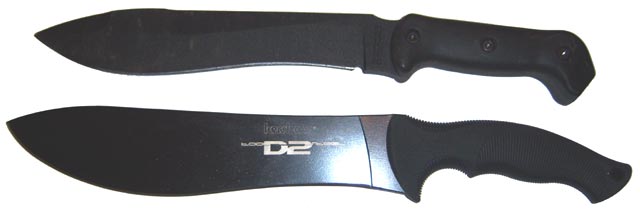

Hello Becker Brute clone :)
Bladite
Was my thought too or like the Kershaw OutCast
that I have though I would prefer a Brute. The Brute is 1095 high carbon & the Outcast is D2 Any idea what the HI MOUNTAIN BOWIE is made of?
I believe HI large blades are Mercedes truck leaf springs. Great stuff for knife blades.
They're all very classic bolo (not bowie) shapes. Something I happen to love a lot :> Oh yah.
I've handled an Outcast at a show... Didn't do anything for me.
I believe the HI Blades are made from 5160 Steel... and I would think that the fact that the steel was used as a vehicle spring prior to being used for a blade, would really tend to "Work the steel".... sort of like when You are building a High Performance motor, some of the best blocks are ones that were in service for a long time, undergoing many cycles of heating, then cooling etc.
Something to do with "stress relieving"
