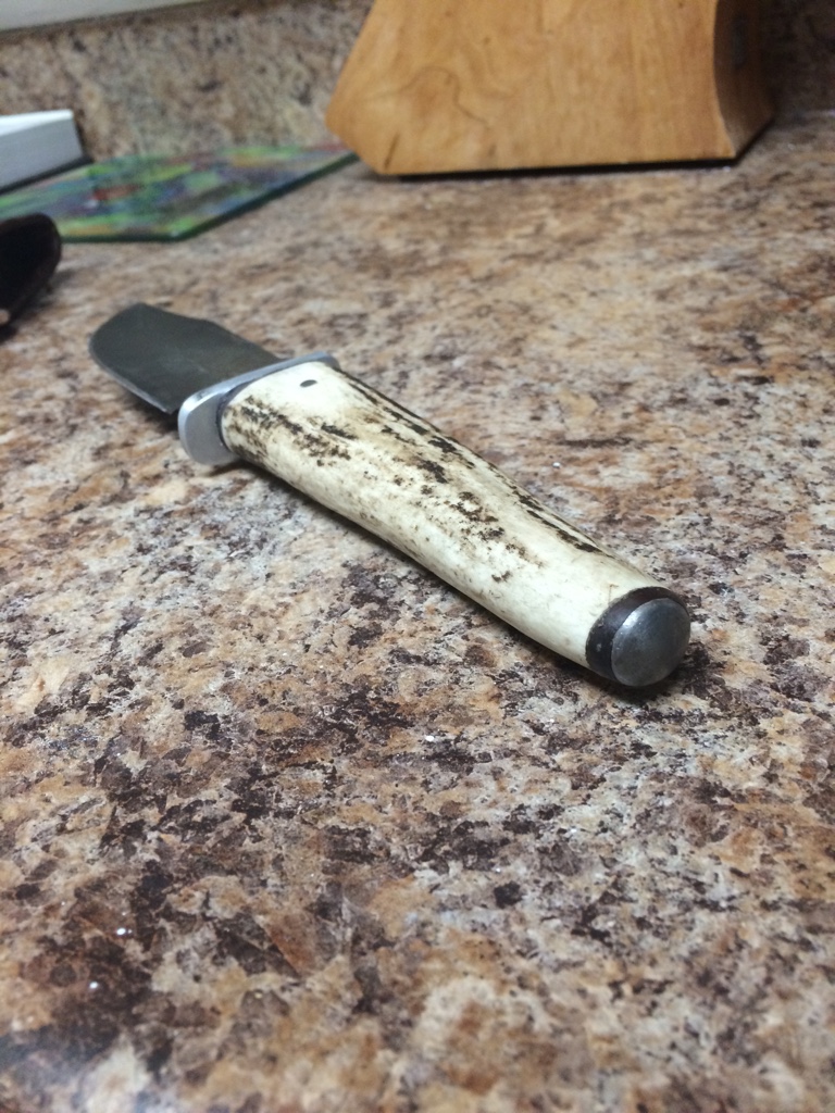

Here is one I did. I am a weekend warrior with this but it worked.
Had the blade made for me and I did the handle. Drilled through the antler, epoxy and then a finishing bolt at the cap that was sanded down.
Was not difficult at all, as this was one of my first knife handles I did.
I just winged it and had fun. Came out great. Take the time on clearing out te antler, it's goes fast and yet can quickly take to much out with large drill bits of that's what you're using.
And measure multiple times if you will put a pin in to hold the blade in.
Good luck! Post pics of the k ice you're going to use! I love wip pictures.

O no offense taken. I was just saying it's possible with minimal experience. Just patience and trust your instinct I guess.
Whe I did mine, the pin was the most nerve racking part because it was the easiest to screw up.
I but the guard and leather spacer together on the tang and traced where it was on the outside of the antler. Put a dot where it is.
Do that a few times until you feel it is where you want it then drill through and hope for the best.
I used a pin the same size as the hole and tapped it in. If you have a notch to grab the epoxy that could work, I like the look of the pin personally.
Leather spacers look great with the antler
My hole came out crooked, but worked great. I used jb weld for epoxy and just wiped Clean
The tough part for me for the pin was that the antler isn't symmetrical on both sides so it requires a little more patience with it.
Just take your time and measure twice and drill once.
