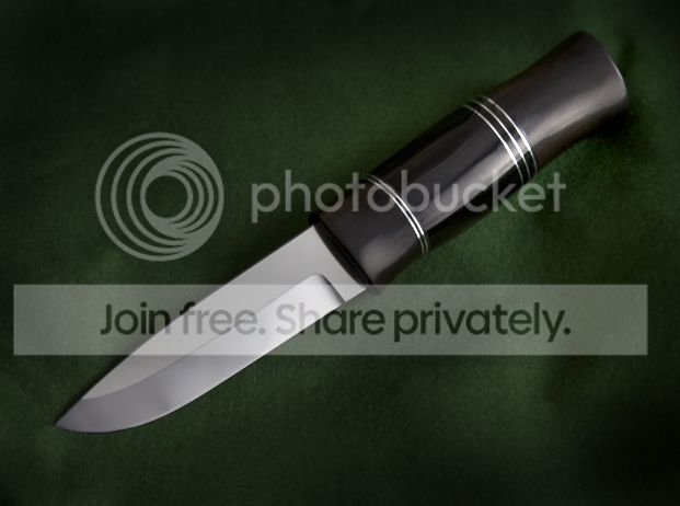

Do kitchen knives need bolsters? I've tried finding a straight answer on this and it's pretty muddy depending on if it's from a chef's point of view or a bladesmith's. Is it a problem to have the handle just terminate, without having something "protective"? I've noticed most factory blades use an integral which is not an option for me, and I don't want to deal with pinning a bolster if it isn't necessary. I've seen custom makers do both so I don't know.
Secondly, do hidden tang knives need pins at all? With the liquid adamantium epoxies available, is pinning just for aesthetics? I ask because I like the look of a pinless hidden tang handle the most, such as these:
Thanks in advance guys!
I like that look too, but I just don't trust the epoxy 100% on it's own.........so I do a longer thru tang with a nut at the rear even on light duty stuff.
I am no kitchen knife expert, but I don't see any "need" for bolsters other than esthetics..
Darcy:)
A reason to have a bolster is that it will be very hard to make a slot in a piece of material exactly as wide as the tang.
Making such a slot on a bolster is still not easy but do-able. That bolster will cover a slightly wider hole to house the tang and have a closed handle.
If you make the bolster out of metal and the slot got a bit to wide you can tap around it with a ball peen hammer to narrow it again. Sand the surface flat again with some sandpaper on a flat surface.
Randall is known to make knifes without pins and they have proven themselves.
I use a self made kitchen knife with no pin and it's solid as a rock
I don't believe full tang kitchen knives need bolsters - they are just there to make the knife look nicer. If you use a good epoxy, like Acraglass (from Brownells) or G-flex (from West System) you don't need pins. The only thing pins will do is keep the scales in place while the epoxy is curing.

Hmm...I was thinking of trying the "burn in" method...do you think that would still be a problem?
Thanks to others for the info.
i don't see problem apart the risk of having ugly "port", wich a properly slotted bolster prevents.
I trust modern epoxy bond, so the pins are just not necessary in my opinion in a kitchen knife.
The added security provided by a pin may have reasons to be in a big fighters, swords...choppers...and so on which you may wield with whipping motions.
