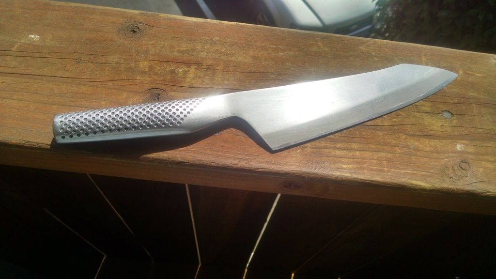

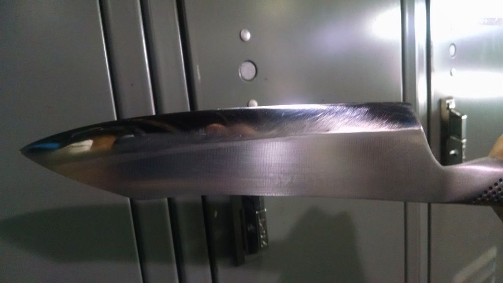

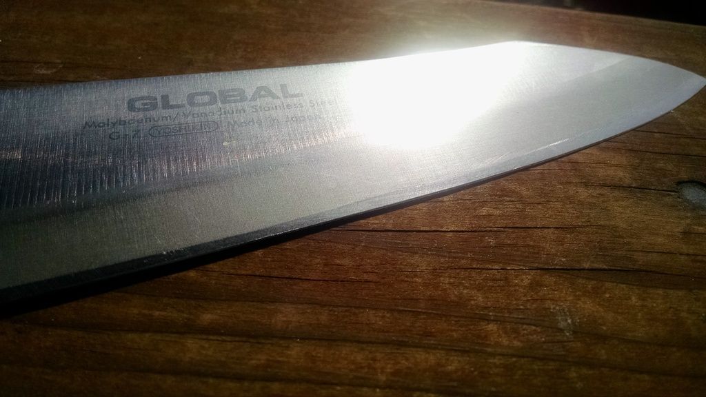

Here are my current results with this setup.
After
So, the Sharpening you are doing is not the normal sharpening that most everyone thinks about. This is Japanese kataba sharpening. It looks like you are doing fairly well but two things stand out. First, that is a deba, 2k-4k should be the edge finish for that type of blade, higher grits will only make it less useful. Second, you don't need an 8k you need a 2k to bridge the gap you have between the 1k and 6k. It might not sound like much but the 2k makes a big difference and allows a much easier transition to the 6k.
In this case I would recommend the Shapton Pro 2k, it's a harder stone and will work well with the deba. If used to finish it will yield a more ideal edge and if you like the higher polish it will allow better refinement of the blade road and the cutting edge. It will probably help get the back of that blade a little better too. Having the back Ura polished properly is very important and can make a huge difference in edge quality.
Edge deburring on the type of blade is best done by a few lateral strokes on the back of the blade with the finishing stone. More of a heel to tip edge trailing pull over the width of the stone. If burr problems persist then stropping on plain leather or denim would be my recommendation.
