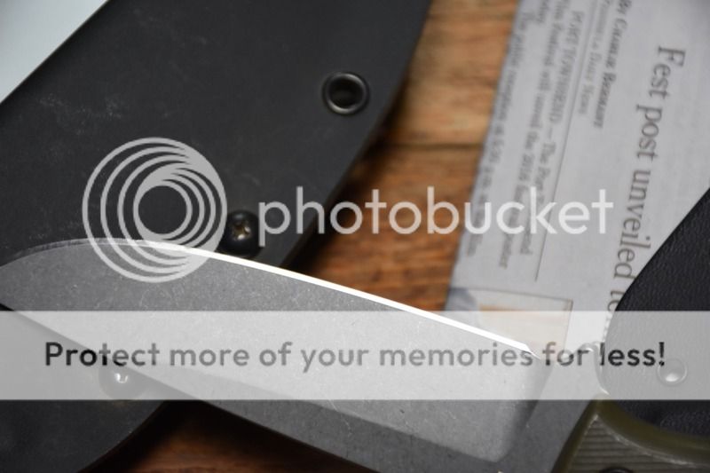

Below: chipping on my custom 3V chopper after bushwhacking salmonberries.
I asked Luong (Bluntcut) if he would examine the chips and tell me what was what. He found a poor heat treat was the problem, with the chips showing overly large gain and grain boundaries clogged with impurities. He offered to do a reheat treat, which bumped the hardness up from 60 Rc to 65 Rc. I’d never heard of 3V being heat treated that hard, and reheat treats are a crap shoot, but Luong knows more about steel than I do by a long, long shot. So I said, let’s do it.
He broke off the tip of one of his 3V knives to compare the grain structure to my 3V chopper, confirming that I had a bad heat treat.

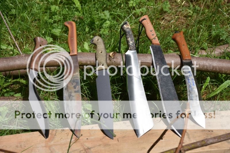

Here are the players:
From L to R: Condor, 3V reheat treat, Busse, Senegal, Fiddleback, W2 test knife
Luong’s W2 chopper at 65 Rc. The spine thickness on this 11 inch blade is 0.3073 inches. The edge width at the shoulders (SEW) is about 0.027 inches. This beast chops with power.
Luong’s reheat treat of my 3V chopper at 65 Rc. The spine thickness on this 12-inch blade is 0.1375 inches, and the SEW is 0.037 inches. This is a thin blade that packs power and penetration.
Busse’s Bushwhacker Battle Mistress in Infi steel (58-60 Rc). The spine thickness on this 10.5-inch blade is 0.2075 inches. The SEW is 0.053 inches. This is a fairly agile blade with proven steel.
Bark Rivers’ Senegal in A2 steel (58 Rc). The spine thickness on this 14-inch blade is 0.1925 inches. The SEW is hard to measure because of the convex edge, but at the same depth as the other blades it runs about 0.027 inches. This is a beast of a chopper and hits with massive power.
Fiddleback Forge’s custom machete in 1075 (maker does not publish Rc hardness). The spine thickness on this 16-inch blade is 0.089 inches. The SEW is about 0.033 inches at the same edge depth as the other blades. This is a light blade that is really meant for lighter brush. It’s agile and an excellent slasher, but way out of the league of the other choppers. I included it for reference. I love this machete.
Condor’s khuki in 1075 (56-58 Rc). The spine thickness on this 9,75-inch blade is 0.297 inches. The SEW is hard to measure because it’s an extremely convex grind, but it’s about 0.06 inches at the same depth as the other choppers. This is a different knife design, but a classic design and I wanted to include it for comparison.

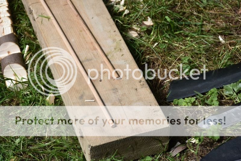

3 — Chopping into a 4x6 Douglas fir block to test for edge penetration.

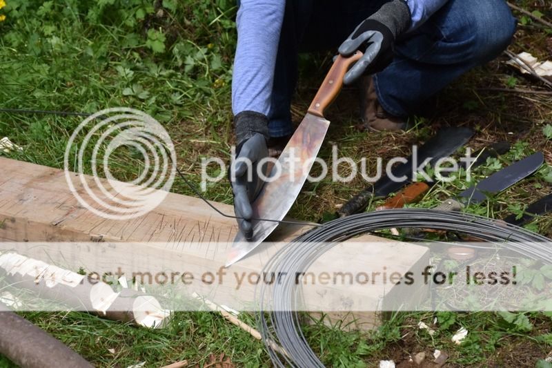

4 — Chopping thin bailing wire as a more extreme test of edge stability.

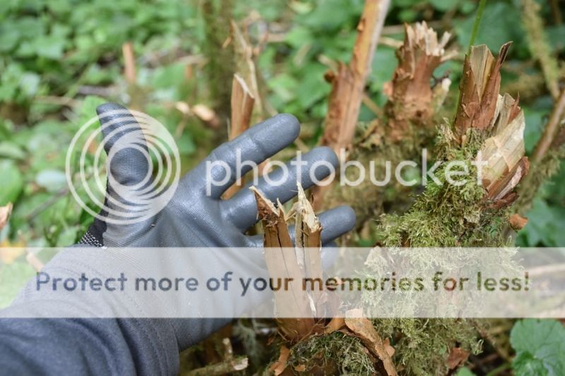

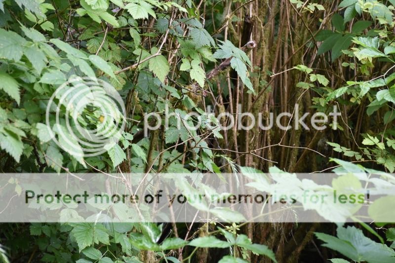

5 — Chopping though heavy salmonberry brush to test chopping performance and edge stability.

The third test was penetration into a 4x6 block of Douglas Fir. None of the blades suffered edge damage, but the penetration was far different.
6th was the khuki, which had great difficulty sticking in the block. It’s geometry was too thick.
5th was the Fiddleback machete, and I’m not sure why, perhaps because it lacked mass.
4th was the Busse BWBM.
2nd was a tie between Luong’s W2 test blade and the Senegal. Both put it to the Doug fir block.
First was the long, thin 3V chopper. It’s length and thin profile buried deeply into the block.

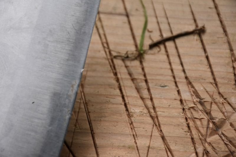

The really tough test was the bailing wire cutting. I didn’t try the Fiddleback machete because it had already failed on the oak dowel test. All blades suffered edge damage on this test, although not too severe.
5th was the Senegal. It’s A2 steel suffered a dent/roll easily worse than any of the other blades.
4th was the khuki, which suffered slight damage.
1st was basically a tie between Luong’s W2 chopper, his reheat treated 3V chopper, both of which suffered very slight damage, and the Busse Bushwhacker in Infi steel. This result surprised me because Luong’s blades were much harder than the rest, so normally they would have been exceptionally vulnerable to this test, especially with a thin edge geometry. Luong does a great heat treat.
The Busse BWBM actually suffered the least damage, but not by much. This classic steel known for its ultra toughness was suffered slight damage, just a bit better than the other first-place steels. I put it in a tie because it had such an advantage in geoemety over the W2 and 3V choppers. The BWBM had a much thicker edge width - far more stout than Luong’s knives.
The last test was bushwhacking through heavy salmonberry. This was a subjective test. My girlfriend did the test with me, and we independently came up with almost identical results.
6th was the khuki, which to be fair is not meant to be a heavy brush chopper.
5th was the Busse, mostly because it had a shorter blade. It, too, is not designed as a machete, despite the name.
4th was the Fiddleback machete. It is awesome for light brush, but not as good for thick, woody brush. It suffered edge damage, the only blade to do so in this test.
3rd was Luong’s W2 test knife, which was surprising because it’s not a long blade. It’s power hitting really helped against the thickest stems.
2nd was the long, thin 3V chopper. Its length and thin profile made it efficient at chopping.
1st was the Senegal. Although heavy and not something I’d want to swing for long, it’s length and mass was murder on thick, woody branches and stems.

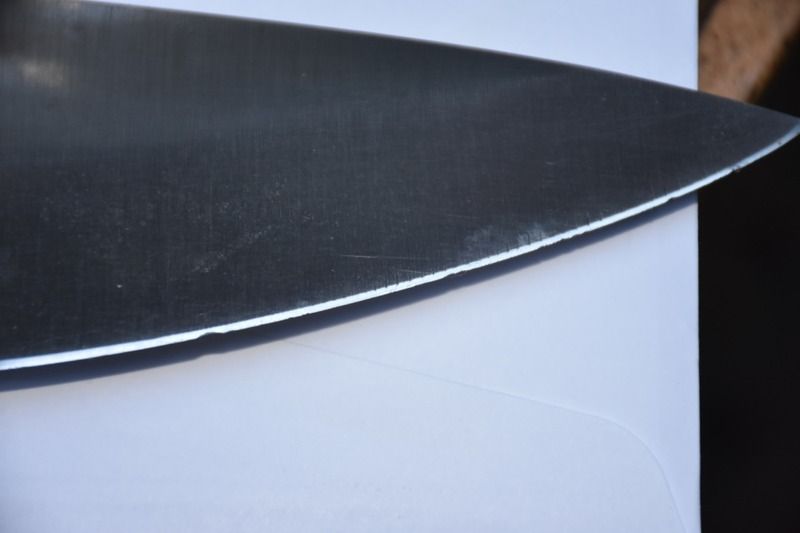

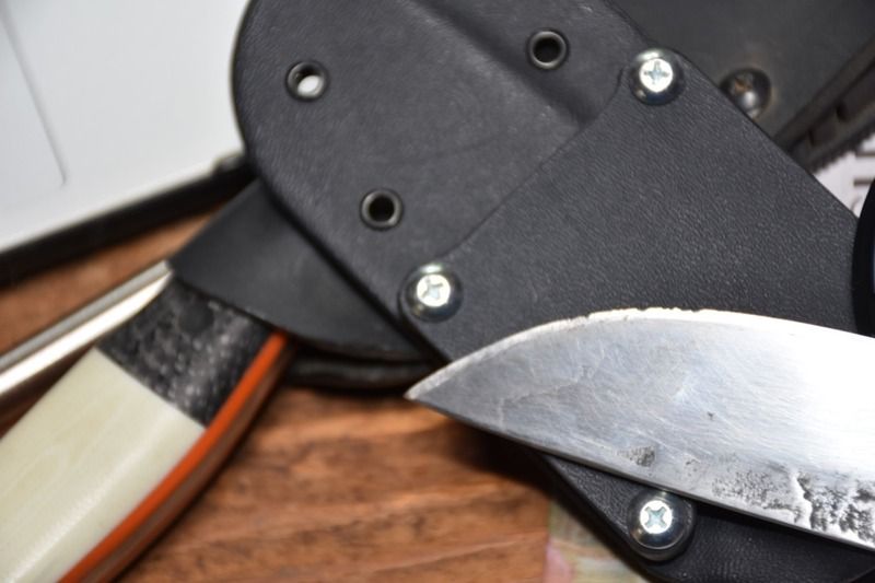

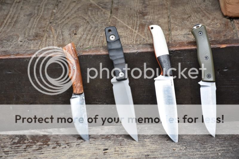

I wondered about the edge damage suffered by every chopper in my test. So I decided to put some high-end knives to the same test.
From L to R: My custom hunter in 1095, Crusader Forge in S30V, Gilson in M4 (64 Rc), Carothers 3V at about 60 Rc.
Nathan Carothers’ 3V field knife is highly respected — and it’s blade was very sharp. It, too, chipped, maybe a bit worse than the Infi and Luong’s 3V and W2, but it was close.
My 1095 hunter is hand forged and has passed my toughness tests before, but the wire test was murder on its edge.
The Crusader Forge in S30V had minor chipping, not much. The Gilson M4 at high hardness (64 Rc) also had very minor chipping.
Testing and using is the only way to find a choppers limitations. The wire test to me is a tricky one, as it really requirers a different approach to a wood chopping/chipping edge, or even wood cutting edge.

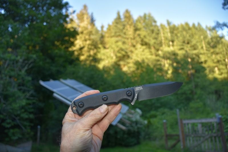

As a final test, I dug out my Zero Tolerance 0180 in Vandals 4 Extra steel. I bought this after reading Bodog's review on this super tough steel.
I did the standard wire test, and the damage was extremely slight. I could see the damage only under magnification or in just the right light. The blade still cleanly sliced notebook paper after whacking the edge on the wire very hard. The big choppers, of course, were hitting the wire with much, much more power just because of their greater mass and length; so I can't call this a winner. But it is awesome steel. Hard for me to imagine going back to traditional steels.
Vanadis4E is very tough for a high carbide volume steel, result reflected that. Outside of edge geometry, bale wire chopping task is fair (physics wise) for all test blades - big & small. Wire is a softer version of nail, in my testing - there is a narrow range threshold of pass/fail edge geometry. Range for blind-folded:p chopping nail on solid metal backing: 0.015"BET+16dps to 0.018"BET + 18dps. Wood backing: 0.018/18dps - 0.02/20dps.

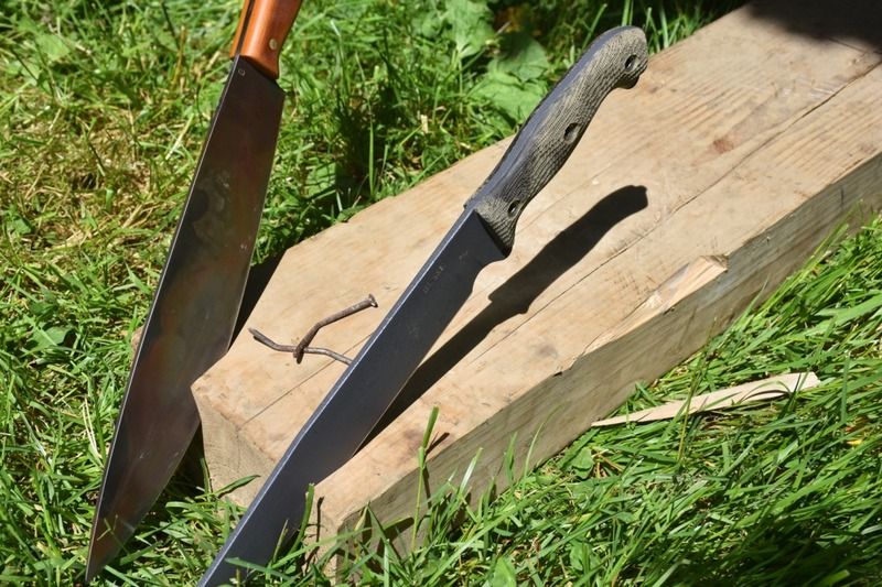

I was talking with a highly respected knife maker, and he said a more telling test would be trying to chop a 10d (3 inches) nail in half. I had resisted tests that hard because I didn't want to destroy all my good knives. But I did try it with my Busse Bushwhacker in Infi, which is a modified A8 steel known to be extremely tough, and the re-heat treat that Luong did to my 3V blade.
I didn't try any of my other choppers because I knew they would all fail. I had already sent Luong's W2 test chopper back to him, and wouldn't have done it on that blade because I didn't own it.
The results: I put the 10d nail on my big block of Doug fir, just as with the bailing wire test. I hit the nails as hard as I could. I could not cut them in half, but they cut part of the way and then bent. This was the same experience I had with the wire, except that Luong's re-heat treated 3V chopper and his W2 test choppers were able to cut the wire in half on several of the blows. Both the nails and the wire end up being driven into the wood.
After my mightiest blows, the Bushwhacker showed no damage. It suffered more damage from the bailing wire, so that wire must be tougher than I thought. The re-heat treated 3V chopper had a few very small rolls (not chips) that could be seen under a 22x loupe. Infi obviously deserves its reputation. The re-heat treat by Luong also is also incredible. The 3V blade he re-heat treated chipped badly under just salmonberries before Luong's magic.
Remember, the geometry on the 3V chopper is much more acute than the geometry of the Bushwhacker, making it more vulnerable to damage from this kind of abuse.
