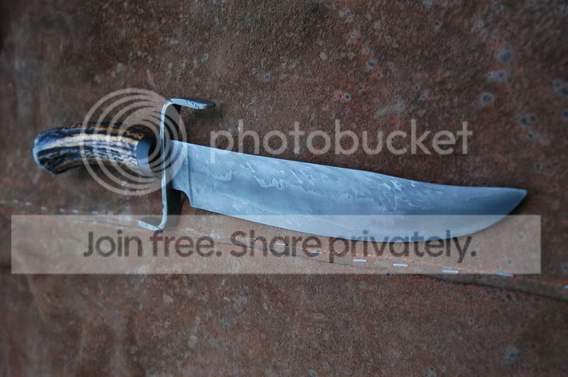

well.. i am already at it again... forged up more cable from darren ellis. nothing fancy this time, just som cable damascus fior a stock removal knife. btw... all my flaws have always been in the very middle of the cable.. has anyone replaced that middle strand with sold steel? i thought about doing that but wanted to ask first.
You will know when its fully welded just by the way it feels under the hammer,for the first few heats there is no noise.Then after some hammer work...sound appears in the mix.
my damascus experience(not much) is mostly with cable.I have had sucess removing the core and replacing with solid steel(w-2) on this bowie
Not quite what I thought it would look like but it still looked good IMO.
By all means play around with it that's where new ideas come from,I just twisted up a billet of 2 different types of cable with a post tensioning cable core,that should look pretty neat.
