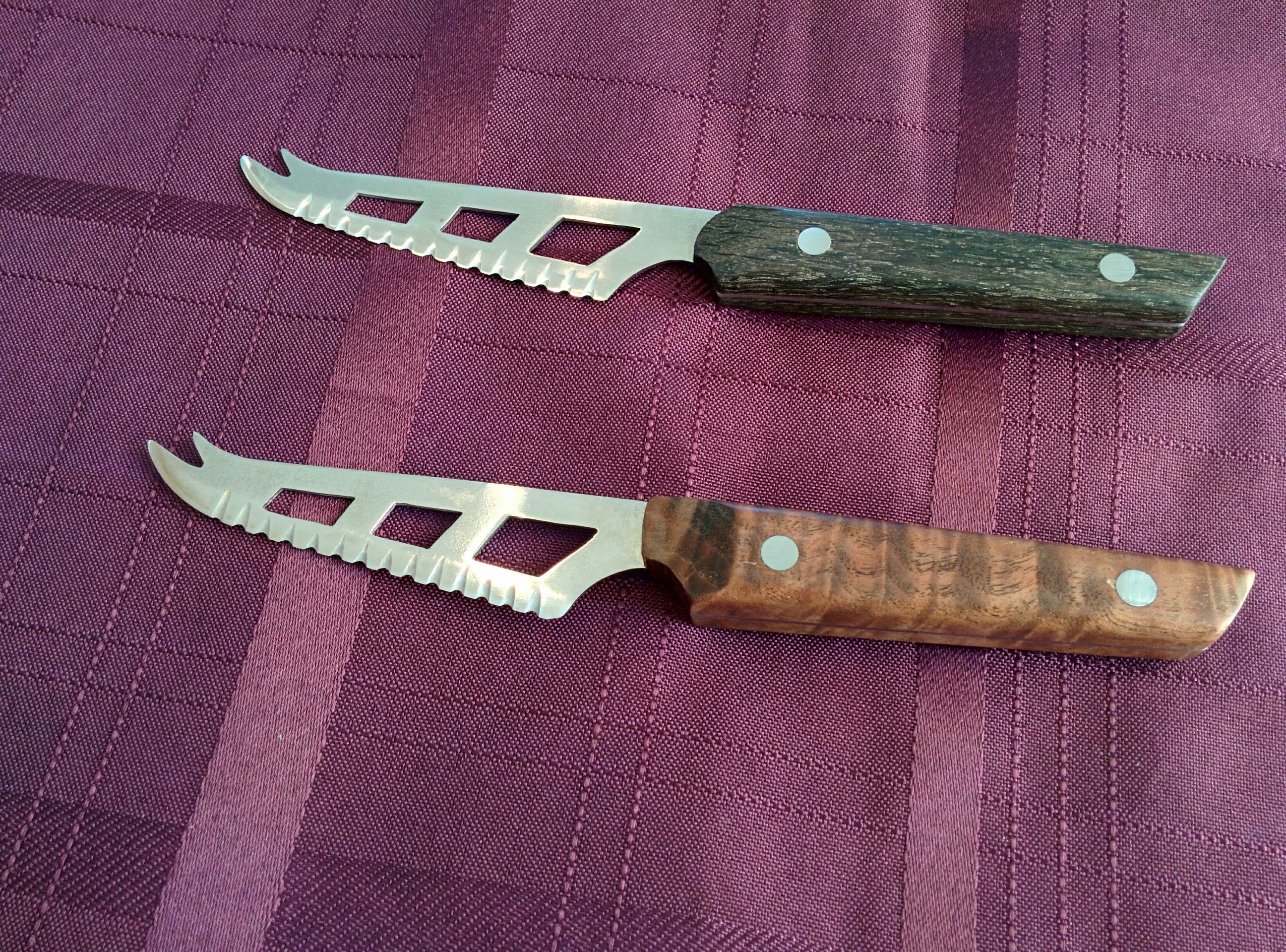

I bought some ultra thin 0.048" CPM 3V to try to make some useful kitchen knives.
(after recently making 3 daggers and 4 subhilts I wanted to reassure family and friends...)
A relative has a cheap old steak knife that cuts cheese with ease, but doesn't cut straight.
It is very thin and also narrow (not much height on the blade) and serrated.
I assume it benefits from low friction being narrow, but that is also why it doesn't cut straight.
Based on that and looking at some commercial models I made the pair shown below.
The cutouts should minimize friction.
They are CPM 3V at 0.048", HT at Peters came out at 61-62.
One has stabilized walnut and the other has stabilized bog oak for the handle.

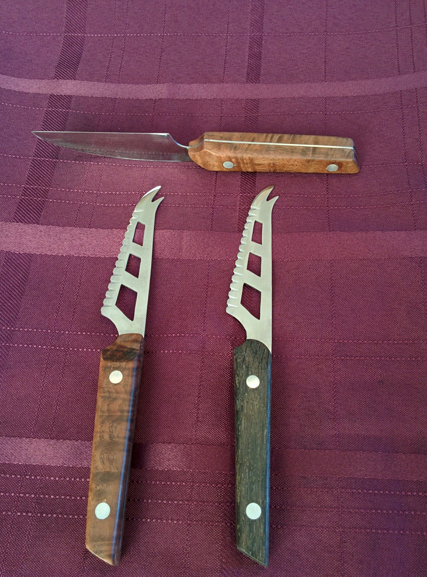

I plan to keep the walnut one and made a matching wharncliffe paring knife.
