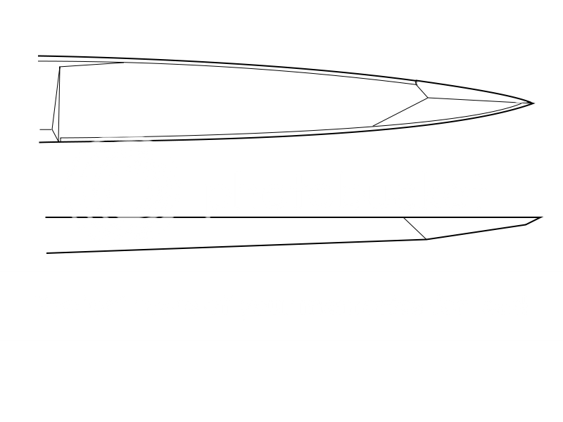

I'm looking into getting some done up with this grind. 3" cut, hot forged 440C, break-down pivot, high leverage bent shanks. The fine point will start holes and make precise cuts in thin materials, while the primary grind is more robust for heavy work on tough targets. We'll see if it comes to fruition or not--it's still in discussion.

CRKT came out with some scissors that convert into a knife , but knife edges and scissors edges are designed for different functions so a scissor blade will never cut the same due to its comparatively obtuse edge, though the chisel grind won't interfere with making low-angle cuts. The handles are designed as they are for a reason, though, so modifying them for use as a knife isn't an easy task. The frame I'm basing mine off of are comfortable for use as such to an extent, but are certainly less comfortable than an actual knife handle. If the project follows through and I end up with them I'm getting some kydex done for mine. :D

To be honest, the self-defense aspect is ONE of the many reasons I'd like to have a pair produced with a point geometry like I outlined, and the break-apart pivot WOULD make it easy for you to use them defensively if needed, or for use as a knife in cases where the other blade gets in the way. Also make for easier blade maintenance, as you can work the backside of the blade to remove dings in an edge without causing problems with the scissors' function. What I was mostly getting at was that crossing functions is doable, but not necessarily easy. Who knows...maybe scissors are the new butterfly swords for urban-goers. :D
