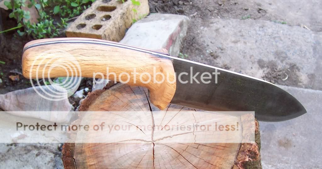

Hi,I asked a frind of mine what steel was used to make C/Saw blades and this is the reply I got.
Some that I know get used for the purpose are SKS-5, L6 and 80CrV2. Generally all fairly high carbon steels with only small amounts of different alloying elements to improve the toughness. Typically run something like 35 to 45 RC, any harder is generally too brittle for using in something that could end up all over the room. They could all be quite a bit harder if you re-treat.
hope it helps a bit.
I have made a few out of old C/Saw blades and they do take on a nice shine.
http://www.bladeforums.com/forums/showthread.php?t=490814
Thanks Tinbasher. Beautiful work on the knife you made too. That's a knife to be proud of. Joe

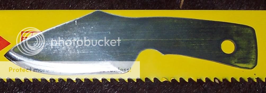

I use high speed steel from power hack saw blades , it comes hard , like serious hard , and can still be heat treated to make it harder yet if you really want to .
My favorite is all hard starret blades , but cleaning them up is not easy , no way Id be able to make them mirror polished with my equipment ( 1x angle grinder )
one day Im going to invest in a belt sander and a buff .
Razorsharp, thanks for the info. One of the problems in these knife forums is that a saw blade of any kind is often assumed to be L6.They still come out as 'mystery steels ' unless identified ! I wonder what the low end bandsaw blades are made from. Nickel does wonders for toughness . A 3 % Ni steel is used in the bearing industry for the toughest case hardened steels for heavy impact load bearings and gears.
I have these saw blades that are long and thick, probably used either for a metal hacksaw (power hack saw, don't know what to call them) (they are used to cut bars of metal) Real curious what they're made of
some of the power hacksaw blades are "bi-metal" ( HSS teeth and softer metal backing ) , some are all hard ( all HSS) in my experience , Im not a whizz at this , just have an interest in scoring cheap / free blades but good ones I can use
its interesting what you can turn a flat strip of saw blade into
