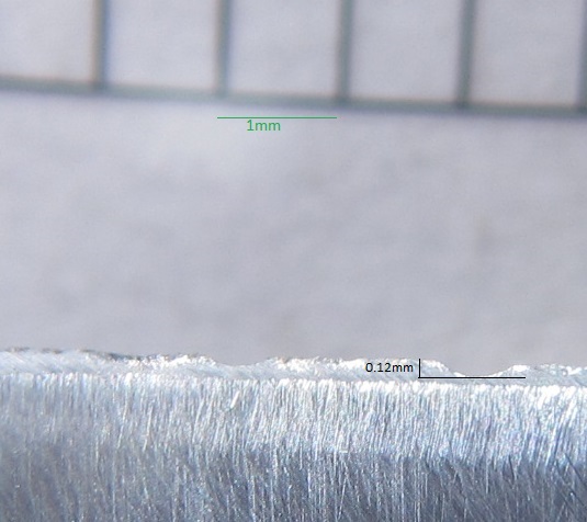

Heheh - it sure wasn't easy to whittle hardened steel rod. The biggest microchip is around 0.12mm / 0.0048" deep. Hence thickness at damaged shoulder ~ 0.0028" / 0.07mm.

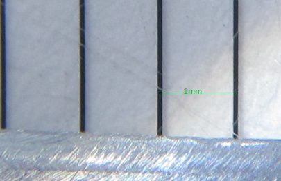

Here is a macro shot of the knife edge after whittled non-work-hardened steel rod
While previous edge after whittled work-hardened steel rod
