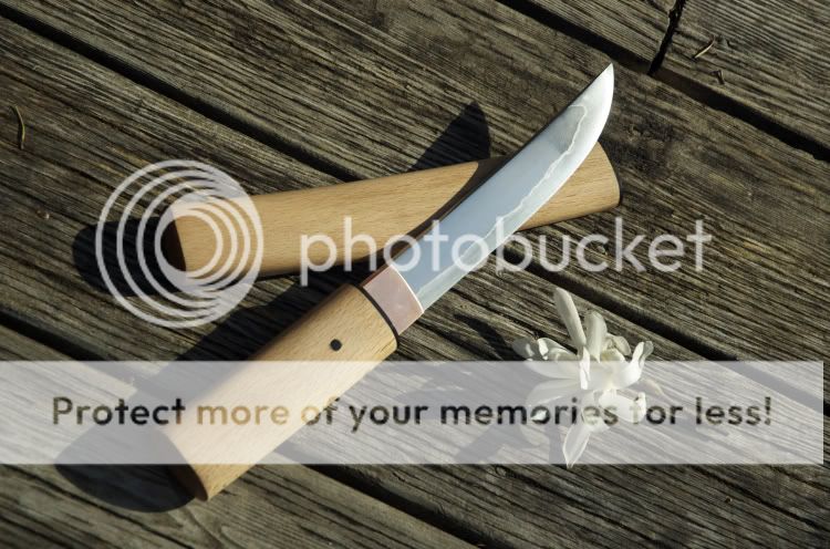

Just finished this this morning after an extremely long an sometimes painful road to completion.

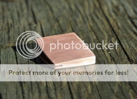

For the habaki, I learned from youtube.

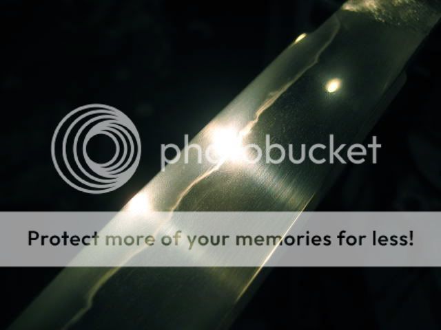

I forged the blade to shape and had an instant visceral thrill from the potential I saw in the shape. When it came time to heat treating, I played it a little on the safe side by quenching in water for 3 seconds then into Parks 50. I didn't have the courage to go for a full water quench.. The sori that developed from the water quench had me giddy. Unfortunately, I didn't treat the clay properly and blew off some of it in the quench. The effects were lack of ashi.. but so be it.
For polishing I went all "Nick Wheeler" on this one :p... well sort of... I got it up to 2500x and realized that I hadn't been diligent enough in removing the previous scratches so back to the grinder I went. Then all the way back up to 2500x. Followed by polish and pumice with my thumb. Hours of work later and I had this. Very little in ashi but some utsuri.
But I didn't stop there. I tried to highlight the utsuri and botched it up so had to go back to 2000x and re etch to get back to where I was. About a 5 hour detour...:rolleyes:

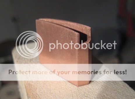

Well.. then I realized that finishing the blade to this before making the habaki was a dumb mistake. Live and learn.. In the end I had to make 2 habakis as the first one didn't seal properly and then I dropped it and cracked it up near the mune:(:(
The second one worked out much better.

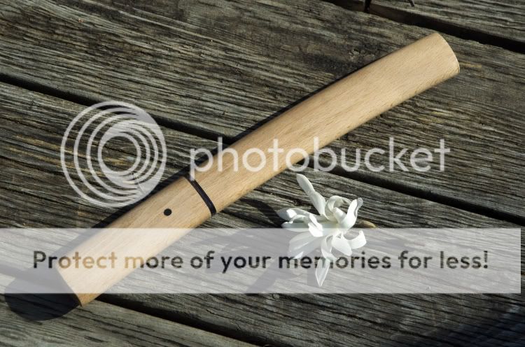

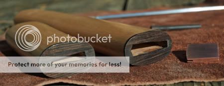

Then came the saya. The alternatives to Honoki in North America, alder and poplar, just didn't look good enough to me so I opted for Beech. Not the best choice both for it's stability and it's hardness but I like the look. :p Accents and pin made of African Blackwood.

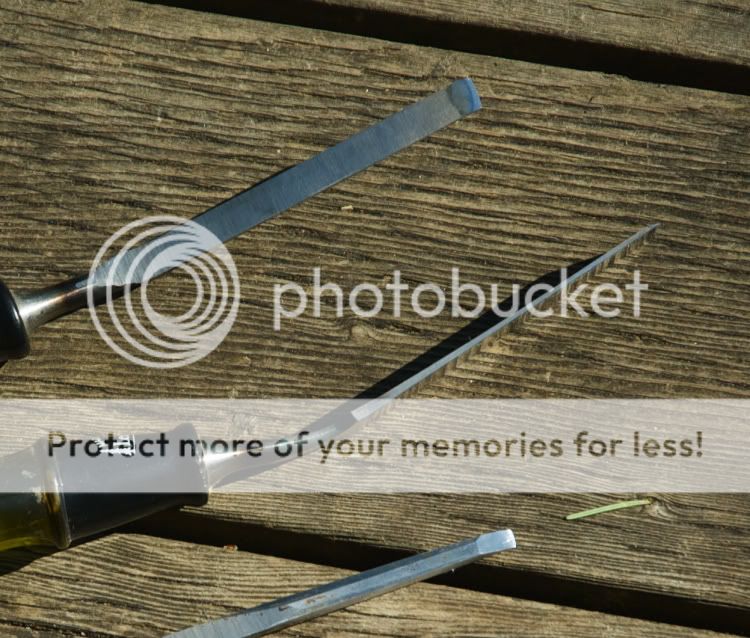

At $500 or so for a set of Saya Nomi or scabbard chisels, I couldn't afford to buy them so I modified some of my chisels to hollow out the channel. I kept them sharp and they worked quite well.

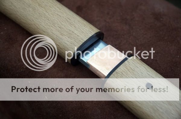

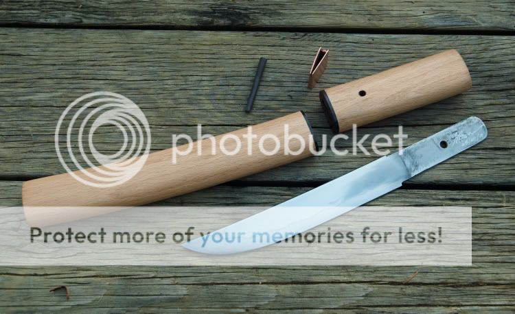

Disassembled

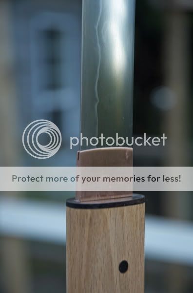

Specs are as follows.. let me know if you want something else.
Steel is Aldo's W2 (not the latest batch)
Blade is 8" from the base of the habaki to the tip with the habaki being about 7/8". Slightly overshot the ratio as the blade is about 1 1/8" at the widest. I guess this makes it a short Tanto but I'm not sure if it should be labelled a Kwaiken.
Thickness at the munemachi is about 7/32"
Sori depth is about 1-1.5mm from the handle to the tip. (not sure exactly how to properly measure this but it is a Tanto. It is very noticeable even for sounding so slight would be considered a Saki Sori as the curve is more pronounced at the tip.
Handle is about 4 5/8"

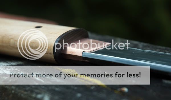

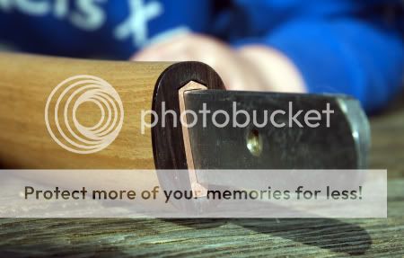

Here's a couple more shots. I thought I did the mekugi correctly but it forced the habaki just a little off the handle. I'll have to sort that out for the next time.
It's difficult to finish these as the fit has to be refined in line with the cosmetic finish. You can't get a good fit then go sand and clean up scratches without altering the fit. It's a headache and a potential disaster. I'm letting myself off a little easy seeing as this is my first try.:o
The friction fit of the habaki into the koiguchi, the sheath opening, is a real tactile pleasure. The last 1/4" is such a nice feeling to sheathe..

It is a tanto.
The blade is measured from the mune' machi(shoulder that anchors the habaki)
Sori is measured thus:
Take a string and tightly stretch from the base of the blade where the habaki would end(opposite end from the mune machi) to the tip of the blade....the widest point between the back of the blade and the string is the sori.
I think the beech has quite a bit of a figure to make a proper shira saya, but would certainly make an excellent base for full mounts.
Best Regards,
STeven Garsson
The beech has a little figure in the along the seam but is a nice and regular "spotted" pattern. A little fancy for a true shirasaya for sure but as I wasn't planning to do full mounts and wanted this to look good...
It's SUPPOSED to look like nothing, grain-wise.....honoki wood used for shira saya has no grain to speak of.
