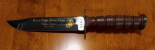

So, it seems that KaBar is offering a limited WW2 reproduction Kabar that is meant to look a bit distressed and all. They call it the "Red Spacer", and it's finish is done with a cold blue solution.
Now, I know cold bluing is not rare for touch ups and such in the manufacturing world, but as an actual finish?... Well, I've never heard of a gun or knife maker using cold blue that way.
Anyhow, here's a picture of the Red Spacer knife that's on Kabar' website...
I personally think that parkerizing it, (phoshating), would have been a better idea, but that's just my opinion 😊
With that said, the cold blued finish does seem to achieve giving it an old school/distressed appearance to it.

Cold Bluing is not more durable than either standard hot bluing or rust bluing in fact it is not a true bluing finish at all. Cold blue creates a very thin copper like coating on the metal that wears off very easily. It's color looks like bluing but that is as far as it goes. This very thin fragile finish actually prevents rust while the foundation of real bluing is red rust which is converted into a black/bluish oxide that resists red rust (the bad stuff that eats away metal.)
Cold bluing is used as last resort for small touch ups where an entire strip and re blue is not practical. It's also included or sold side by side with gun kits and marketed as a convenient fast easy way to blue. It is not a good way to blue metal.
