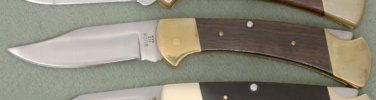

Hmmmmm......Shedua Segua Schmua Baba Lua?
above are a couple of my Shedua 112's...I need to dig them out and get better pics of them...
Flyer
Are the slats in the background Shedua? They would make great looking handle material as well.
Those are Mahogany...I have handled some knives with the wood from a chair from this set:)
Thanks much, 300 and all.......
After looking at these threads and especially Scott Hartman's pics of the bottom edges.....I'm calling it Shedua.
Now I have to snag one with Micarta and I'll have enough knives and can retire.
:D
I don't have much experience with shedua, but I have handled a fair amount of macassar and other ebonies, both in finished articles and as raw wood. It doesn't look like macassar.
Thanks, Lambertiana.....We'll go with Shedua......I suppose now it merits a trip to the Spa, since it will be one of my rare knives.

Second, I noticed on that other thread that Haebbie never got an answer on his potential Shedua, but if he reads this he should compare the top and bottom edges with other 112s of the same vintage and if it's Shedua he will see a difference.
Last, I have a memory trick to remember to call it Shedua.
I'll just think of 110 Dave's famous Shed Juice.
Thank you, BG, for the remembrance. ;)
I'll try to find out.
Here's the knife I told about.
Haebbie
You're welcome and, Yes......I'd guess it IS Shedua and if you compare the top and bottom edges to Macassar 112s of about the same age you will see a difference in the grain when compared with Macassar.
Shedua on left.....note the different look. I checked against older knives with Macassar with the same result.
After cleanup and a little brasso and oil.
No need for the Buck Spa.
I do like my first Shedua.
