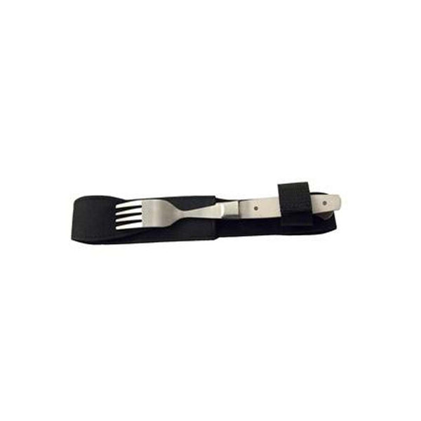

I'm thinking about trying to make some folding knife/fork/spoons ("hobo" knife) for my nephews and I have three questions:
1 - What is a good stainless steel to use for a folding fork and spoon? I probably don't want to dig into my MagnaCut stash for that.
2 - How would you go about making a spoon? I was thinking of cutting it out flat, handling the tang end as normal, and then somehow pounding the spoon bowl in cold with some sort of doming block or something and then heat treating. I do not have forging capabilities. I would love advice or insights if anyone has experience related to this.
3 - What target hardness would you recommend for a fork and spoon? Spring temper? Higher - low/mid 50's?
Thank you.
Jantz sell a knife/fork kit with a belt-loop carrying case. You have to make the handles. I have made several with curly koa handles for friends who camp.
