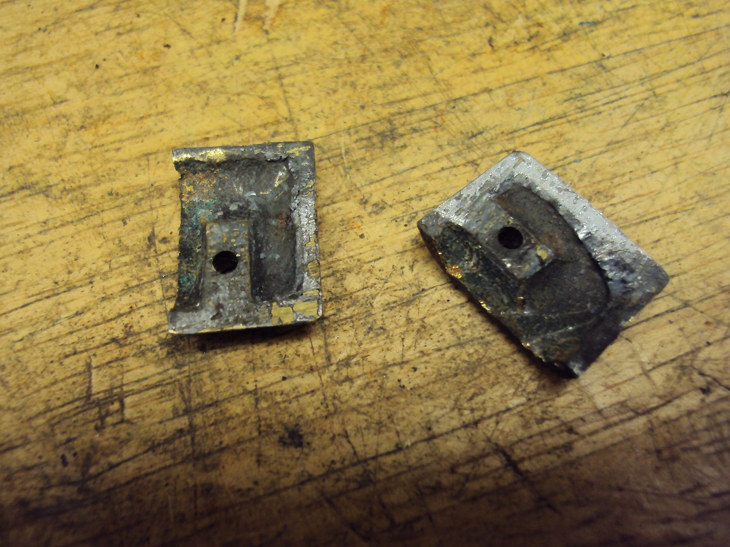

Perhaps more on point, I can visualize exactly what you are referring to on the cast bolsters. I wonder though, what is the normal method of making them? Stamped? Or maybe just cast in such a way that the back is flat or flattened?
And it seems it would be a heck of a trick to pin scales on an assembled knife? Dont the pins on the liner side have to be peened pretty good and ground off? And the center pin, as noted, is usually loaded by the spring (or is it?).
Geez, our beloved slipjoints are so simple in principle, but there is so much "trigger work" in getting them together (design too I believe for the same reasons, tolerances on the things must be a black art).
Final semi-on-topic question: what is that pearl handled knife in the background?
I believe most bolsters are cut/stamped from a solid piece of whatever, and then shaped appropriately. It seems the German/European ones of a certain age were "cast", maybe to save on material costs, not sure. This picture, although not of the bolsters on Will's knife, shows what they look like.
The center pin is loaded by the spring. Some mechanics will install that last when assembling a knife. I like to have it in place, and usually pin the blade pivot pins last. To each his own, I guess. But yes, pinning the covers on an assembled knife, the pins would have to be pretty well finished and mostly flat to do that right.

Oh wow, thanks for the picture. I was thinking just a bit of concave not that shape with the pin boss. Interesting. Are the more conventional bolsters just flat slabs from the back as I imagine?
Wonder why they did that casting? Nickel silver isn't that hard to work or expensive. Maybe just someone overthinking like Swinden!
Most bolsters are flat-backed, and pinned or soldered to the liners. The ones in that picture are brass, so they did it with both brass and nickel silver that I have seen.
As for why, it probably made the manufacturing process easier. With the Swinden system, it reduced the pinning process on a knife to just one pin.
