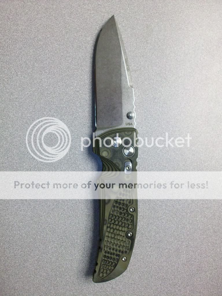

Right off the bat, I liked this knife, its big, beefy, and brawny, but not nearly as heavy as my ZT0303.
All parts and metal, fit together well, with no gaps, and everything had that bright and shiny new knife look. And feel.
In the hand, I noticed how sharp the edges were. With scalloping towards teh blade, and around the handle perimeter, there was a small but acutely sharp edge. Not noticeable at first, but after whittling with it for a while, it can be a little abrasive on the hand. Not cutting or cause hot spots, but I can see someone wanting to take some 600gt sand paper, to knock those corners down some.
The Gmascus, is a brilliant pattern, and one that I really like. The stippled portion of the handle, feels quite good, though it suffers from the same "fresh off the machine" feel as well, very aggressive, but not too much.

The tale tell "spooner" pocket clip, is a dead giveaway for the Hogue knives, and one that I like.
The operation of the blade, is a simple thumb stud opening, with the Elishewitz pushbutton lock, and safety backup. The lock up is tank tread tight, smooth, and repeatable. In other words, a mechanism for a folding knife.
Overall, the fit and finish on this blade is good. The blade is centered, it opens easy, closes easy, and has some pretty aggressive texturing, making it feel like you have a solid grip on it.

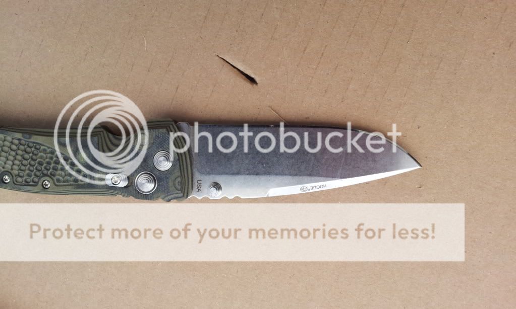

The factory edge was very sharp, and very symmetrical all the way up the blade. I like that. Going in, she'll shave,
Coming out, like I said, if it cuts solid all the way through, and don't dull up so bad I can't finish, its good in my book.

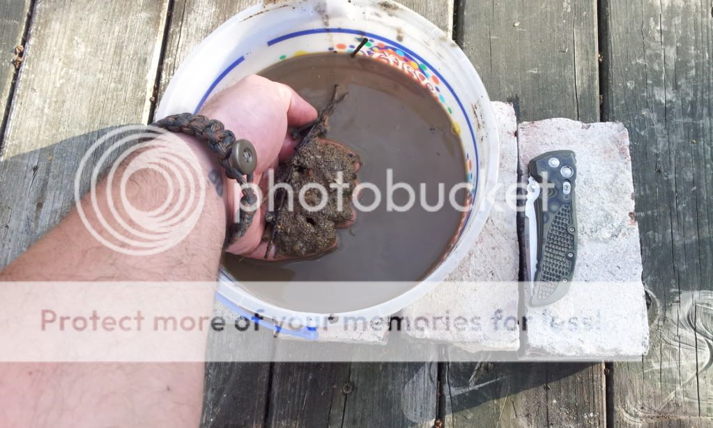

Mud Bucket. Pretty simple test, but very effective for judging a folders ability to work in the wilds. I just recently got into kayaking, and I always keep a blade on my vest, and in my pocket. So, the way I see it, if I'm climbing out of the boat or getting in the boat, and my vest/pocket folder falls, what will it take to keep it running?
So, one standard issue shovel, a bucket (girly, but I have girls, so.....), and a silty, sandy, mucky creek that runs through my land. One scoop of mud, and fill with creek water to a good depth.

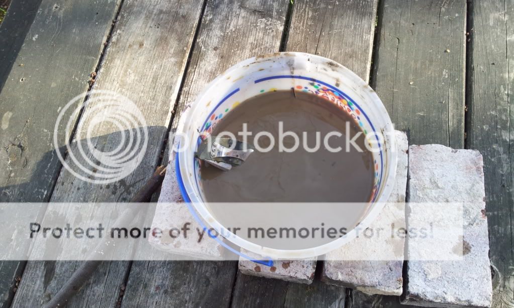

I have a stir stick, as I want all the dirt and silt to be "free" in the water when I add the knife.

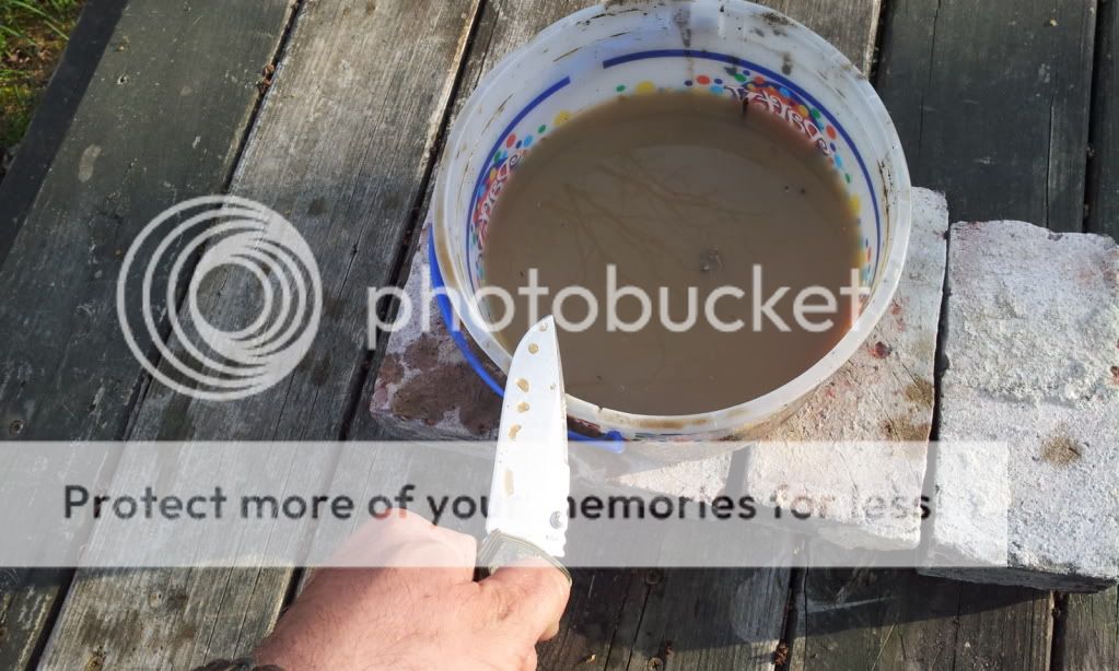

And in it goes. I stir the muck until its all unsettled, then place the knife, folded, in the mix.
I let it sit until the mix settled, then I waited, another 5min or so. This was as I pulled it free.
The first time, I gave it a "swoosh" in the muddy water, after I pulled it free from the settle.
Opened fine. You could feel the sand and dirt in the action, but it moved through, not much more difficult than sans muck.
The lock fully engaged, and the "safety" switch worked.
Closed just as well. The lock button was easy to push, no binding, and I was gently pushing the blade closed.
Second test, I swirled the knife, closed, into the mucky abyss, flipping and turning it over as it disappeared from sight.

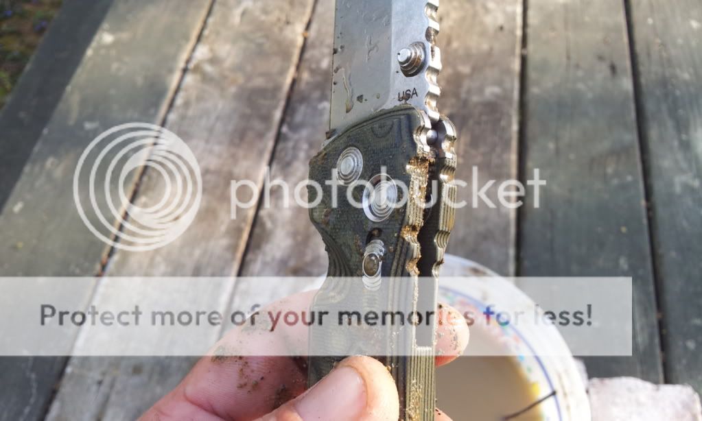

Coming out the second time, no rinse, just a shake. Opened same as before, but you could feel the grit and grime more this time.
I hope you can see how much dirt and sand there is in the action.
The lock this time seemed to bind some, once the blade came into battery.
And to test and see if the partial lock would fail, I spine whacked it a few times on the side of the table.
The whacks actually seated the lock into full position.
