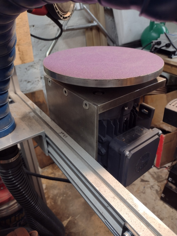

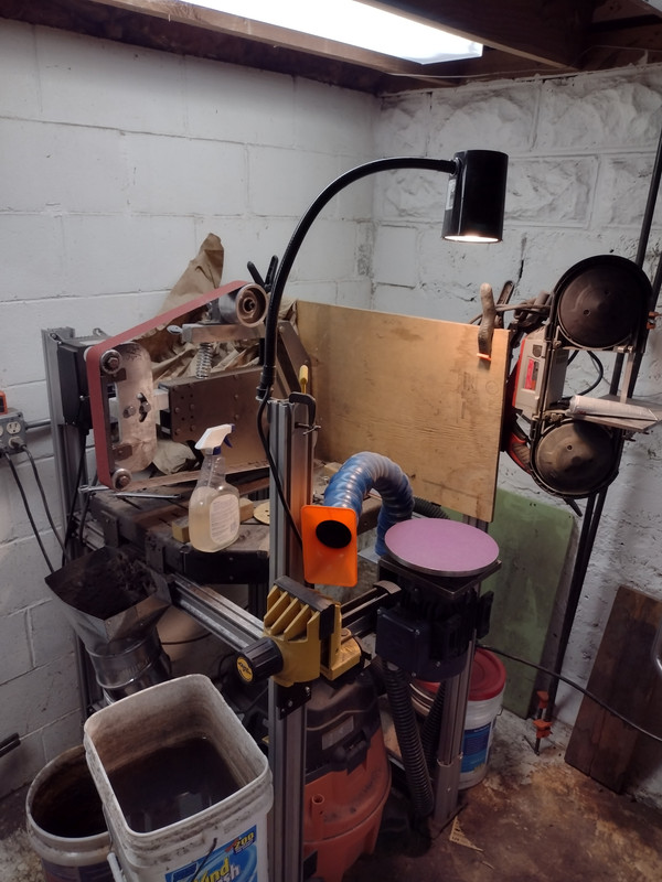

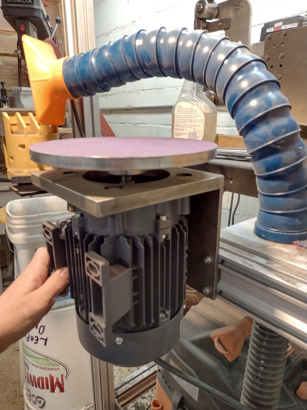

Here is mine I recently made, and posted earlier in another disk grinder thread......
I'm kinda surprised how Fun these are to use.

I lucked into a bunch of heavy T-slot bar in several sizes a while back. Using these versatile bars to temporarily or permanently mount machines is really great. It is quick to mount and unmount things by sliding them in the slots and twisting of a couple lock screws.
You will soon start to see all sorts of uses for holding jigs and such. Catch pans and spark funnels stay in place and can be slid from grinder to grinder.
The possibilities are endless - removable worktables, hand sanding stations, sharpening stations, mounting work lights, small accessory/parts holders or pans for bits and small tools, etc. Many of these can be made to just slide in and out.
Just an FYI, but on Craig's setup I would have skipped the thick top plate/back plate assembly and just mounted a simple plate on the feet. Four holes drilled in the plate would match to the T-slot bar. If using a 3"X3" double T-slot bar you could mount the disc sander horizontal or vertical.

What's ironic/funny is that I have a side mount on my motor...... I didn't Need to make anything...haha. I'm holding it with my left hand in the one pic.
*But I machined my bolt hole pattern and large bored plate before I salvaged the motor and drive. 🤣
