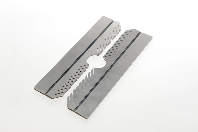

Hey guys,
What is the best solution for the mag chuck on my surface grinder letting small pieces slip? My chuck is an older model with really wide poles, so small parts don’t make much contact with each pole. Slipjoint springs slide across the top pretty easily. I’ve seen some people use these fine pole blocks magnetized to the chick and they become magnetic as well, holding smaller parts better. Would this be a good solution? I’d hate for it to not work because they’re pretty expensive for what they are. Thanks

I block mine in with thinner stock. I also find the areas with greater pull by dragging the spine over the chuck while turned on.
Hoss
You might look into something like the magna lock holddowns:
Sometimes called "magna grips, magna vises, perma grips, or magna clamps... etc... They're mainly used for non-magnetic materials, but can be used for mildly magnetic parts. The biggest issue is their price tag, which I've never understood. Even used sets will set you back at least $100-200. I've been thinking of trying to make my own, as there really isn't much to them.
I just use razor blades to stop slide. They're always thinner than any stock I'm surfacing and have decent surface area. And they're cheap and always on hand anyway.
I've got some of these, almost never use them. They're not really useful for helping with thin stuff, typically, they're thicker than the stock you're having probs with.
Block the thin stock with thinner carbon steel stock (like contractor razor blades, which are flat, as John mentions), on each side and the end direction where your stone is pushing the work piece. Typically that's enough.
However, the best solution, is to replace your chuck with a cheap fine pole model. Which run around $200 for import ones that are decent. They're not the best in the world, but will be 10x better than a clapped out old standard pole, no matter how good it was originally. Frankly, they're better than any standard pole, old or new.

Those magnetic parallels wont really help in this case. They're really more for holding odd shaped parts.
