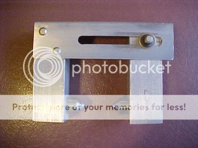

Hi,I made a tool for flaring the tubular rivets used on a lot of knives .I just open it enough to get the knife plus scales in then lay it in my vice ,as you close the vice it just slides in the slot.Worked well on a Busse I modded .All three parts are Aluminium angle.
Thank you for looking.
Richard

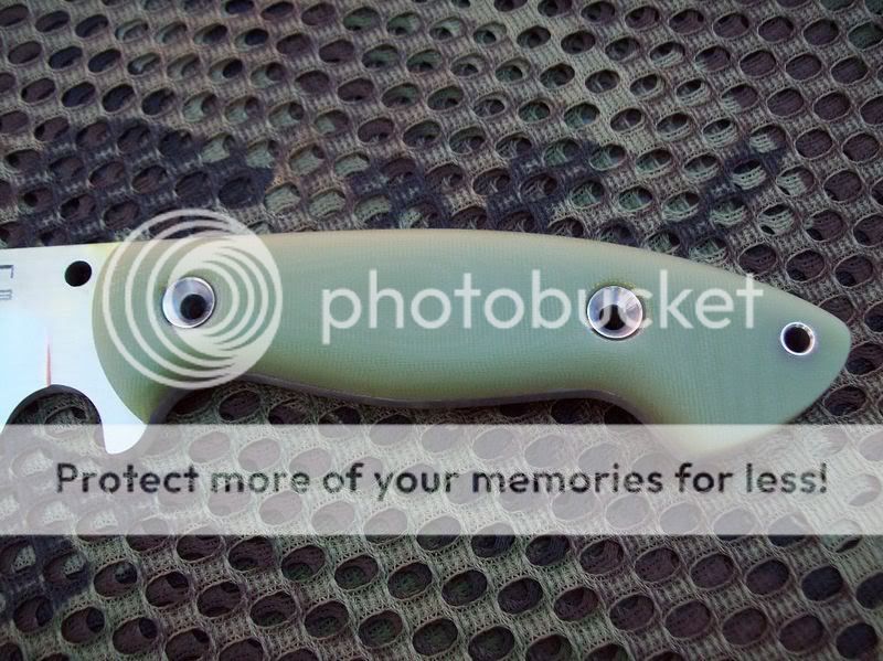

I work closely with a forum member here, "Flatgrinder" We have collaborated on several projects, the most recent being a combat style fixed blade w/green G10 scales. The scales were held on with epoxy and flared rivets like you're describing. It was my first attempt at using this method and I must admit, they looked and worked great ! Flatgrinder turned some similar looking dies for me to harden, temper and use in the installation of the flared rivets. I took my vice jaws off of my large vice and drilled for the dies to slip into. The principle being very much like the tool you've made. Flatgrinder posted a most excellent tutorial quite a while back of which I followed precisely to mount the scales. It worked perfectly http://www.bladeforums.com:80/forums/showthread.php?t=471416

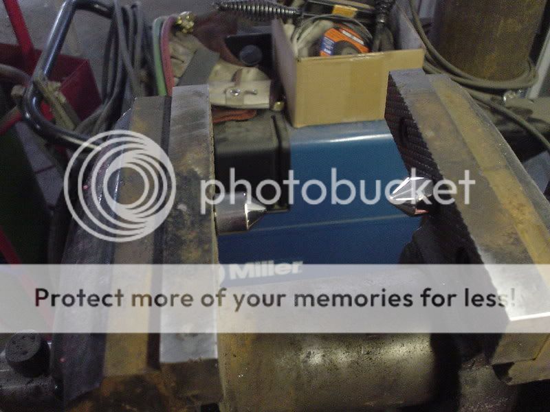

Here's a pic of the the flaring dies Flatgrinder turned, mounted in my vise.
you should put the flaring dies on a pare of wide mouth vice grips.
Great ideas guys! The info is especially timely for me, as I am about to attempt to flare my first set of hollow rivets.
chris, good luck! just remember to practice on a piece of scrap first, tubing is cheap next to redoing a set of cracked scales.
also countersink and lube up the inside of the tubes. i don't know if it helps for sure, but it doesn't hurt.
The trouble with vice grips is they don`t open with the jaws parallel to one another .
Richard
That and the fact that you would need a "grip-o-steel" to flare the tubes. I had to use quite a bit of force on my first attempt at flaring the tubes. So much in fact, that I'm not sure I would feel comfortable using scales made of anything other than G10 or micarta.
Siguy's suggestion of using some type of lube is a hot tip. I used some heavy axle grease on the flaring dies and applied it several times during the flaring process. I gave a good turn on the vise handle, checked, turned a little more, checked again....... etc., until I had them where I thought they should be. Like I said earlier, Flatgrinders tutorial is very detailed and I followed it to the letter with perfect results. Make sure you have a nice countersink in your tube ID (like Siguy mentioned) for a good start to the flare and also make sure the tubes are centered in the scales.
That looks great, David. I have a piece of green electrical g10 like that but haven't used it yet, it goes nicely with the stainless tubes.
