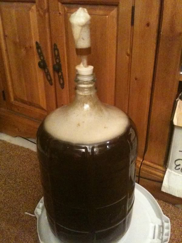

So who makes their own Beer?
This is my 4th batch, its a Stout, should be ready for NYE

Wow, you ARE serious! This one actually gave my first Beer Incident, when I came in this am it had blown the air lock off, hit the ceiling, beer spots all over, wasted about a beer worth,dammit.
I need to goto a 6 gallon carboy
Or you could get a big blow off tube instead. Goto lowes and find some vinyl tubing that will jam into the mouth of the carboy and put the other end in a bucket of starsan solution. All the kruesen will froth out into the bucket, along with some other stuff that's nice to not have in your beer. I think the size tubing you need is like, 1 1/4" OD, can't remember exactly though. That way you can fill the carboy to the top, after it's foamed out you're usually left with almost exactly 5 gallons. :)
I was just about to post "Dude, what's up with your airlock?" :D Are you sure your beer wasn't too warm - something has to expain that rampaging fermentation!
I agree with c00per, using a blowoff tube is a great way to go. It becomes especially useful with Hefe's who often have a lot of kreusen.
Another suggestion, if you're looking for one, is to use non-glass carboys. The glass ones break very easily and when they break - :eek:
Do a search for "Better Bottles" - http://www.better-bottle.com/
They work great, I really like them. I don't use the ones with valves, just plain-old carboys. They're light, clean easily, and don't ever pose the risk of a big huge glass accident.
Enjoy!
Thanks guys. I didn't know the foam had a name, still new to this. The first batch I had to cool, the fermentation bubbling were pretty calm, but it was all I knew so I thot that was normal. Then I made a Hef, OMG! Volcano. OK, so THATS normal. This Stout it way more active than the first, I have it at room temp so I figured that was why this oine is so much more active. Will be interesting to see if thereis any change in the flavor profile, its the identical recipe to the first batch.
I might go with the better bottle in a 6 gal size for beer making. Will keep the 5 gal glass for wine.
If you haven't already, check the yeast that you used and find out what the recommended temperature range is for that particular yeast.
If it's too cold for the yeast, it won't do a very good job at converting. If it's too warm, you'll get flavors you may not want.
There's ways of keeping a fermentation at a desired temperature - to cool, you can wrap towels around the carboy, wet them, then put a fan on them (evaporative cooling). To warm it up, you can get a heat blanket for carboys to warm it up. You can also warm the room some if needed.
Lastly, I find that making a yeast starter is very effective at getting a strong fermentation. You can get "starter kits" to make starters, you basically are brewing a very small batch of wort, then pitch the yeast into that and let it get started. Then, you pitch the whole thing into your big batch of wort and stand back :D
